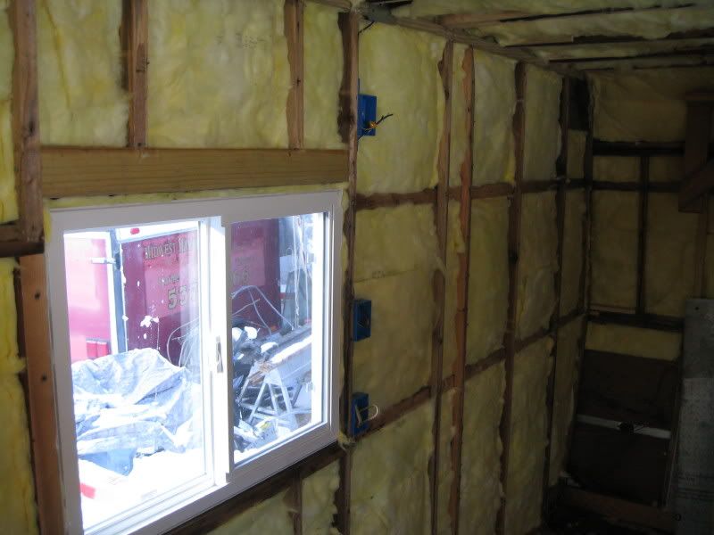

I've replaced two of the three windows I planned on and have removed two, all together. Those vacated jalousie windows are framed and will become insulated wall.

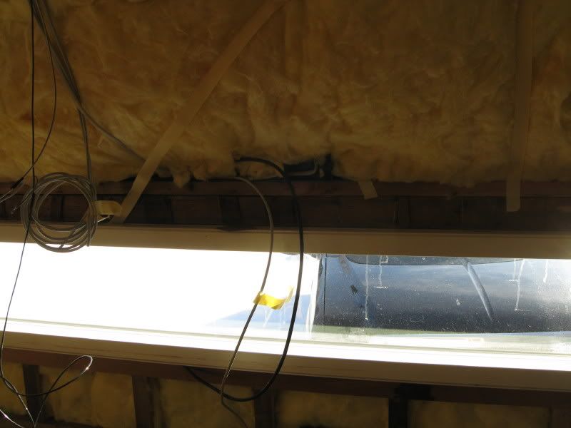

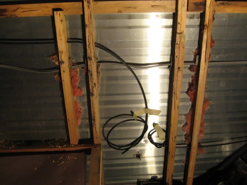

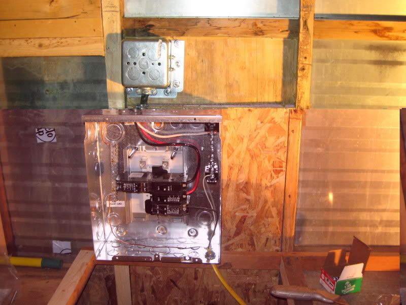

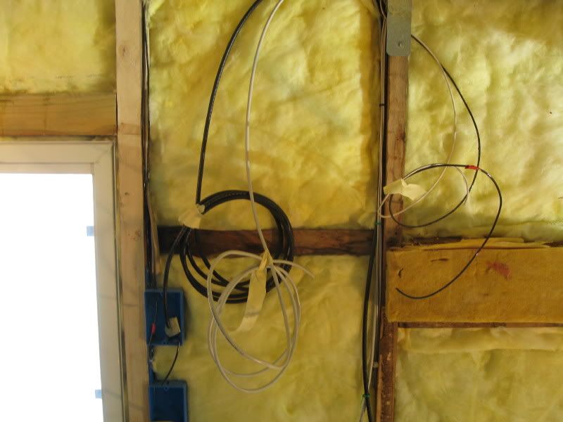

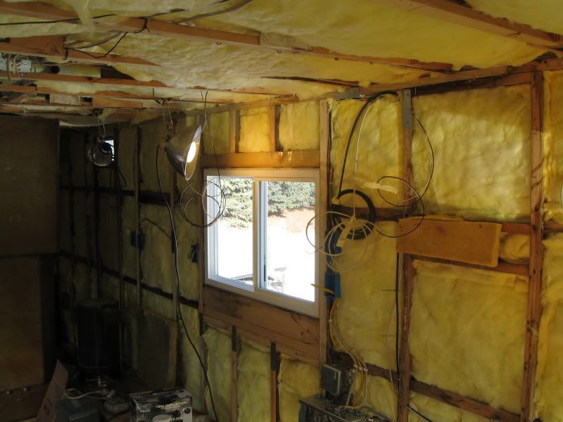

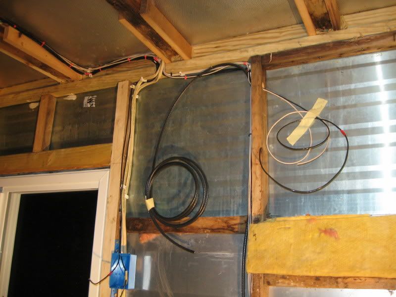

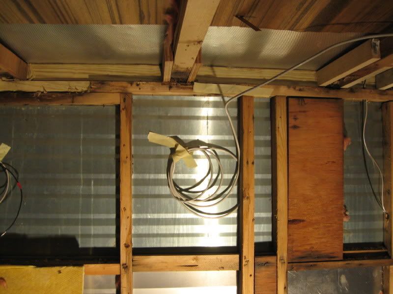

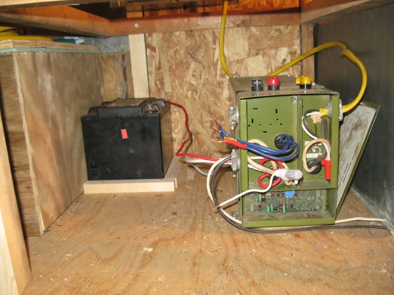

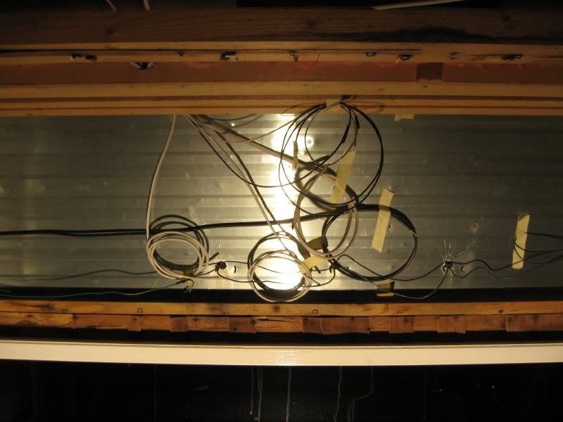

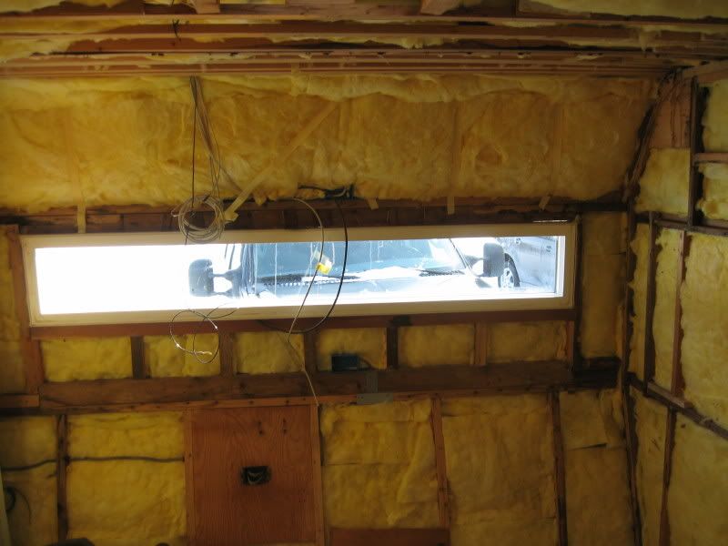

Tomorrow, I'll be replacing the 72" front window and will then move on to the wiring. The existing Precision Dynamics converter tested to be OK and has a solid state battery charger so I will use that for the DC. I am upgrading the older 30 amp service to 50 amp. If there's interest, I can post some more pictures up of the restoration, as I progress, and am always open to any ideas from others.

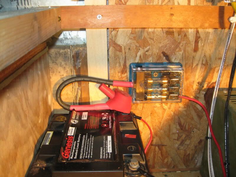

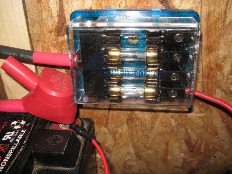

I allowed some space for additional batteries if needed.
