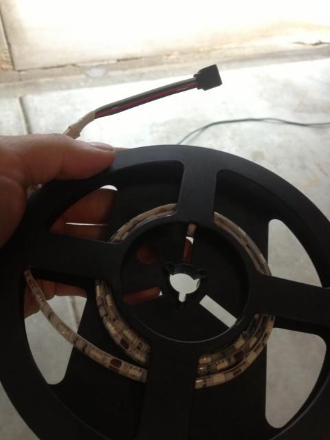

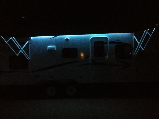

Most every project that I attempt outside of work(I am a carpenter) ends up having complications or just not going smoothly, even the simplest things. This project actually went real smooth and turned out surprisingly well so I feel the need to show pictures!
I've seen some threads where people go through the power awning power access area but mine was full of foam. I had to think of another approach so I bought a PVC junction box to hold everything water tight.
Used an old laptop power supply plug end to wire up to the 12v.

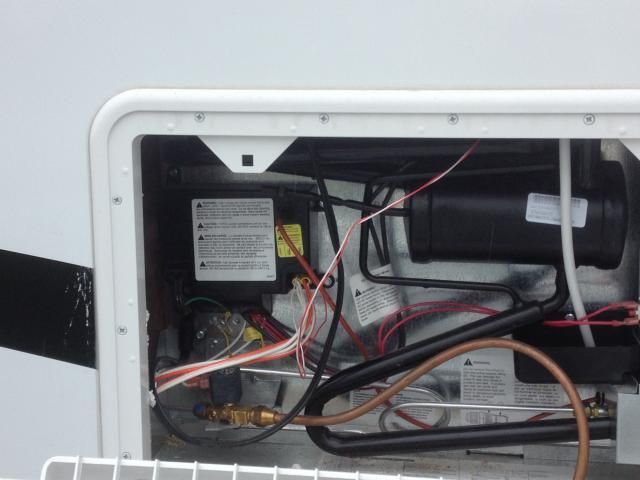

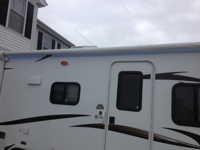

Everything tucked in the box with IR sensor out the bottom. I got the 12v from fishing wire up over the roof, down through the refer vent and spliced in behind the refer.

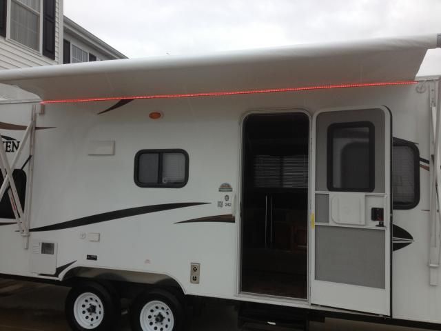

All closed up.
