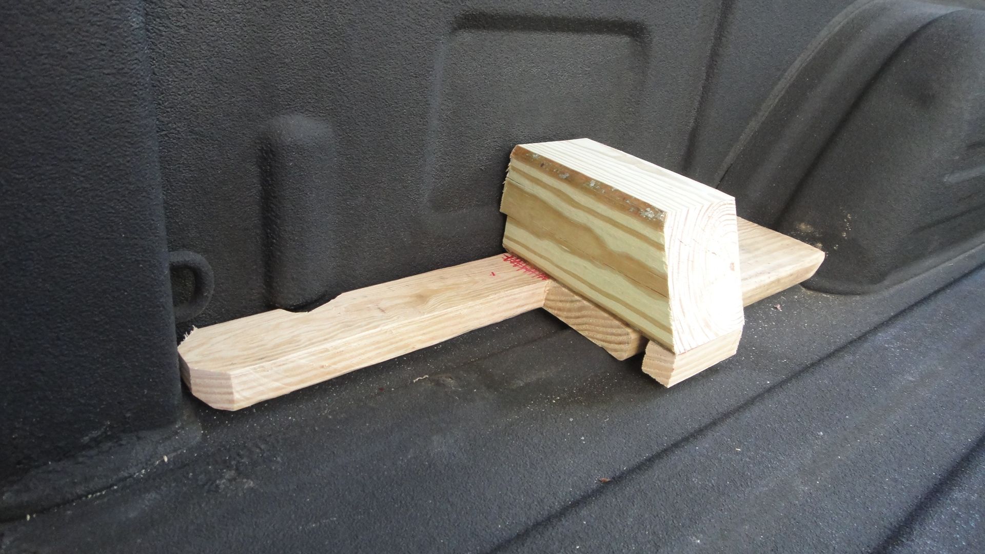

Device for Alignment and Centering of TC when loading
I recently made some simple, easily removable, parts for inside our trucks bed... to load, align, and keep the TC centered... I'd like to share them with you.
With these easily removeable blocks we just back our truck under the camper until the front of the camper touchs the two front slopeing guides, lower the camper and everything is aligned and perfectly centered. As the camper is lowered the front bump guides moves the front of the camper away from the front bed rail... to stop the rubbing that nost of us want to avoid.
Why is this important to me now after all of these years? Janet and I have been under the surgeons knife, physical therpy, and healing for the last 10 months... it made me realize that there might be a point when I'd need someone else to help me load (Janet has been watching recently for safety reasons)
