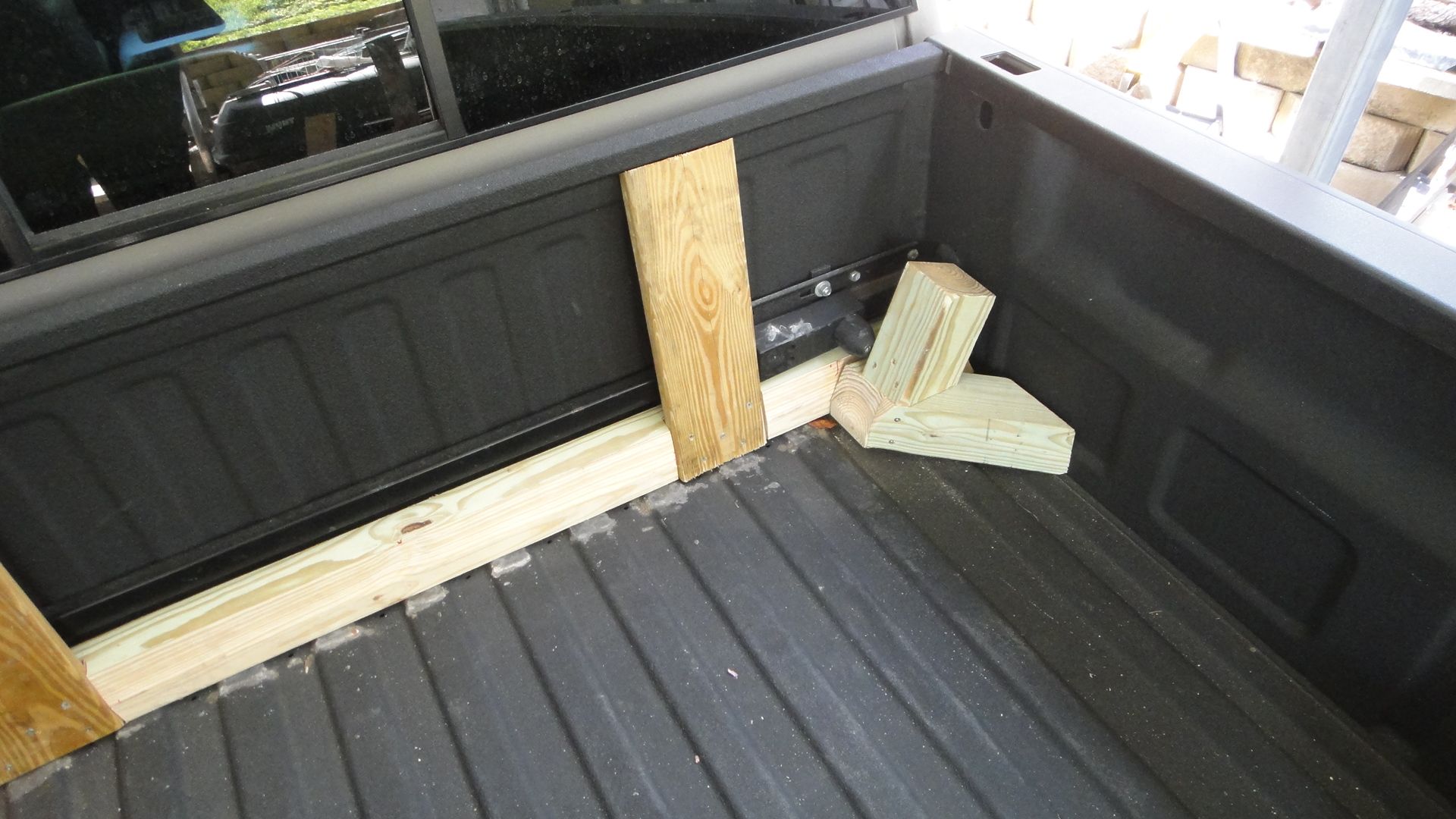

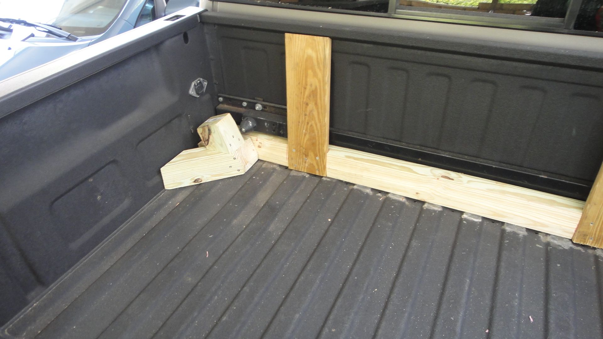

I recently made some simple, easily removable, parts for inside our trucks bed... to load, align, and keep the TC centered... I'd like to share them with you.
With these easily removeable blocks we just back our truck under the camper until the front of the camper touchs the two front slopeing guides, lower the camper and everything is aligned and perfectly centered. As the camper is lowered the front bump guides moves the front of the camper away from the front bed rail... to stop the rubbing that nost of us want to avoid.

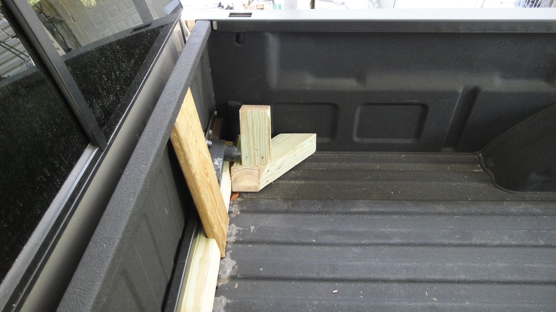

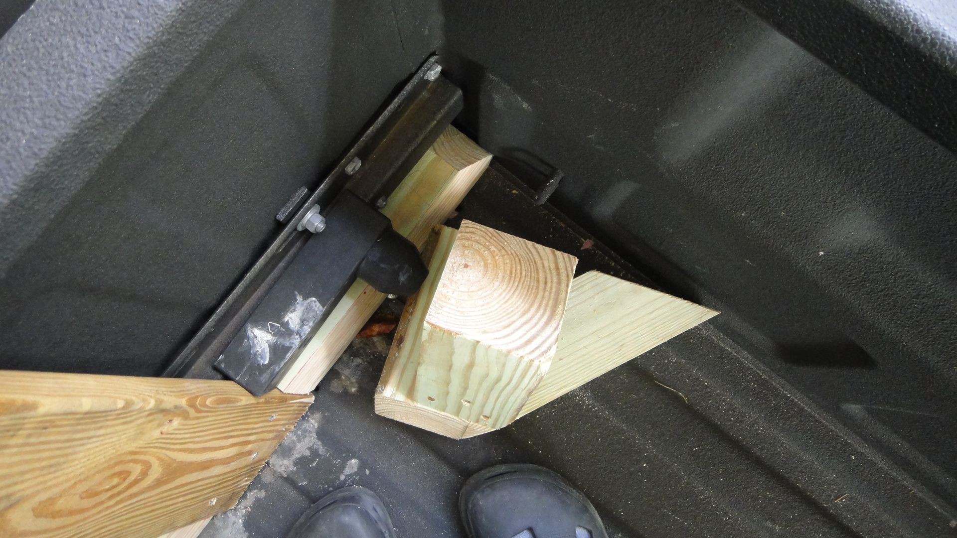

  • A look across the front... to see the angle of the front guide and the width of the forward stop.

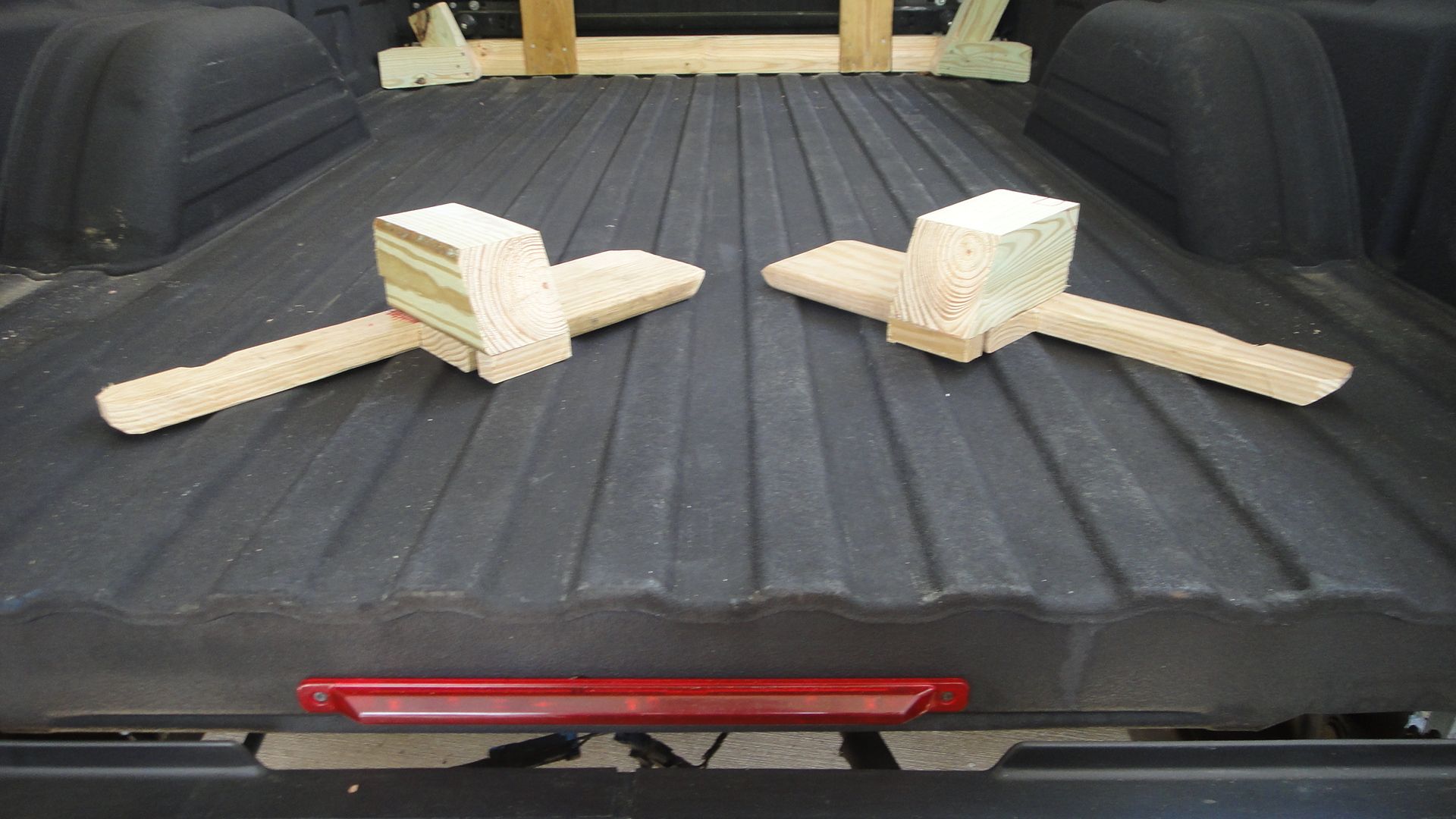

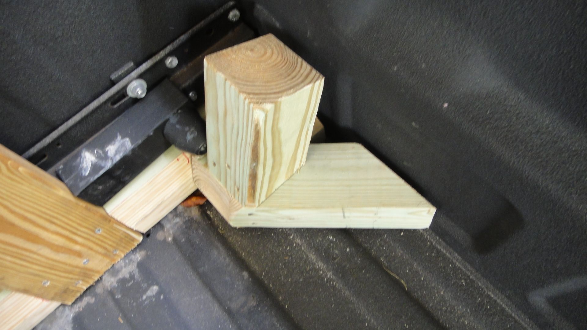

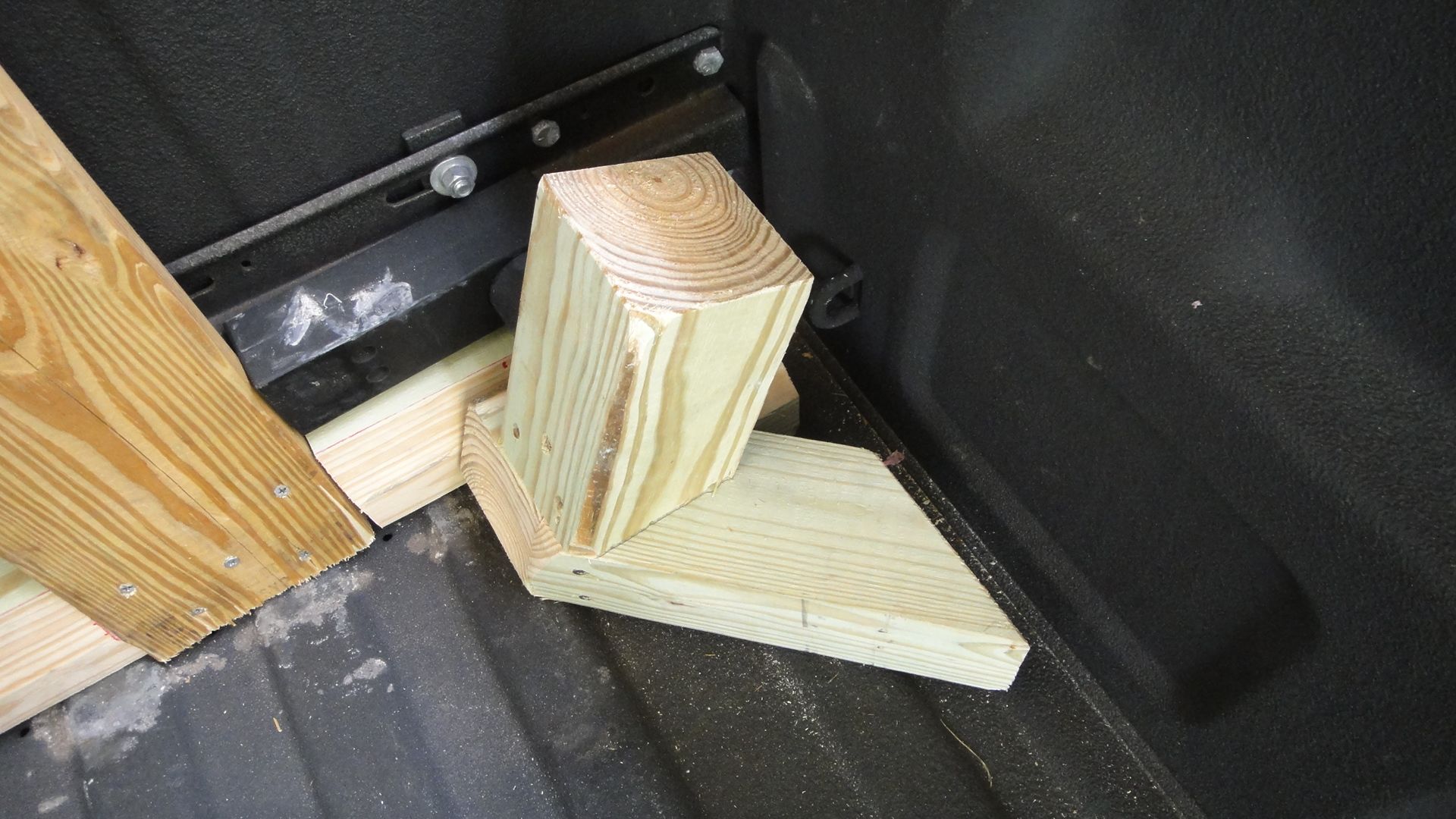

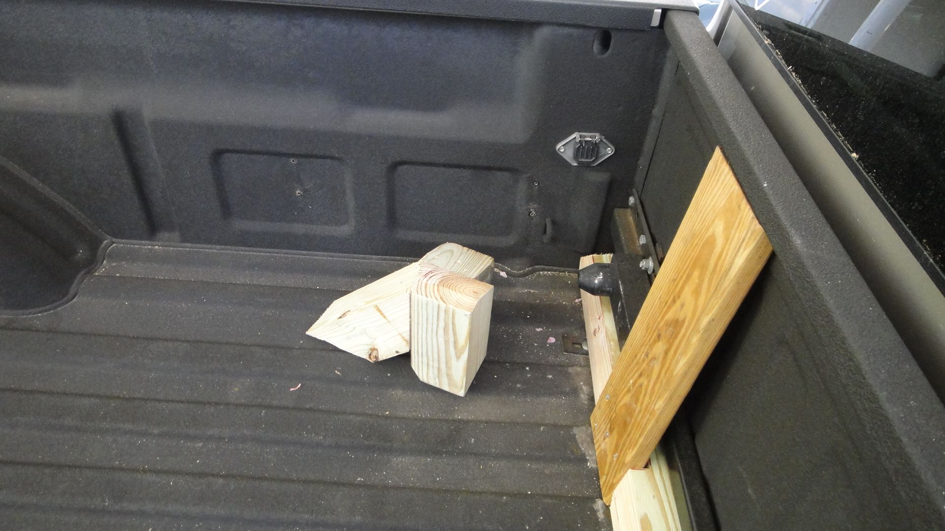

  • The second picture shows here the "guide" is slide back under the existing happijack guide

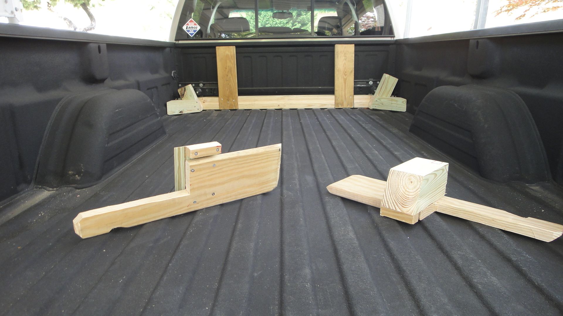

  • The units aren't attached.. just wedge fit into protrusions in the truck bed.
    The second picture is the part flipped on its back like I did on some earlier pictures.
