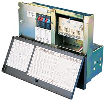

The only real advantage of a three stage converter is the bulk charging and the desulfination modes.. Bulk mode allows for quick charging and desulfination helps keep the battery in top condition.. - RoyBExplorer IIThe charger is part of your converter function. This provides 12VDC for your trailer needs when plugged into shore power 120VAC. At the same time the converter also charges your battery. If you disconnect the converter/charge unit then it will only run off the battery which defeats the purpose of having dual modes.

- RoyBExplorer IIThe Magnetek was bought by Parallax. The 7345 is a 45 amp regulated converter with a fixed 13.5 volt output.
You will need to inspect your battery on a regular bases with this unit to make sure it is not boiling out your battery fluids...
I would plan on replacing it with a moderm SMART MODE Converter/charger unit... IOTA or PROGRESSIVE DYNAMICS are good reliable converter/charger units especially if you plan on adding additional batteries for camping off the power grid...
I would not buy a WFCO COnverter/charger unit as they have a track record of not going into SMART MODE charging when you think they should be...
Contact RANDY at BEST CONVERTERS or get a replacement from AMAZON...

The converter says it's a series 7300 with model number 7345. I think it's magnetic.
Magnetek ... upgrade kits are available. - OasisbobExplorerMy 01 Trail Lite does not charge. Converter has not charged for years. Too spendy to fix.
