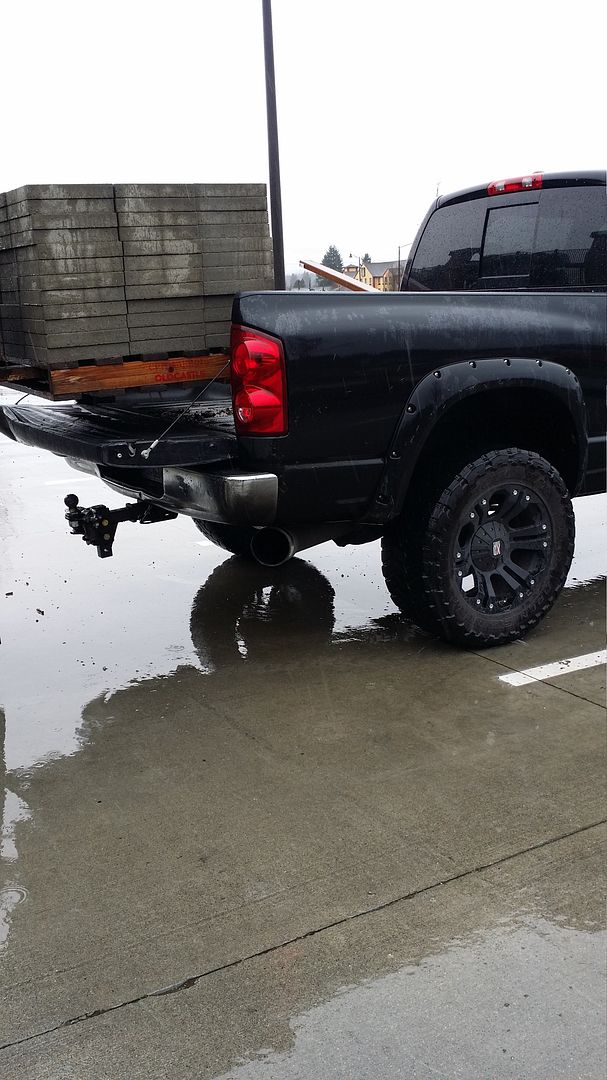

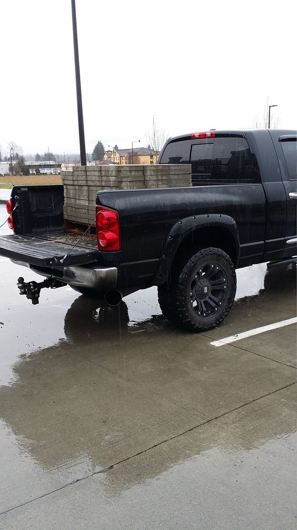

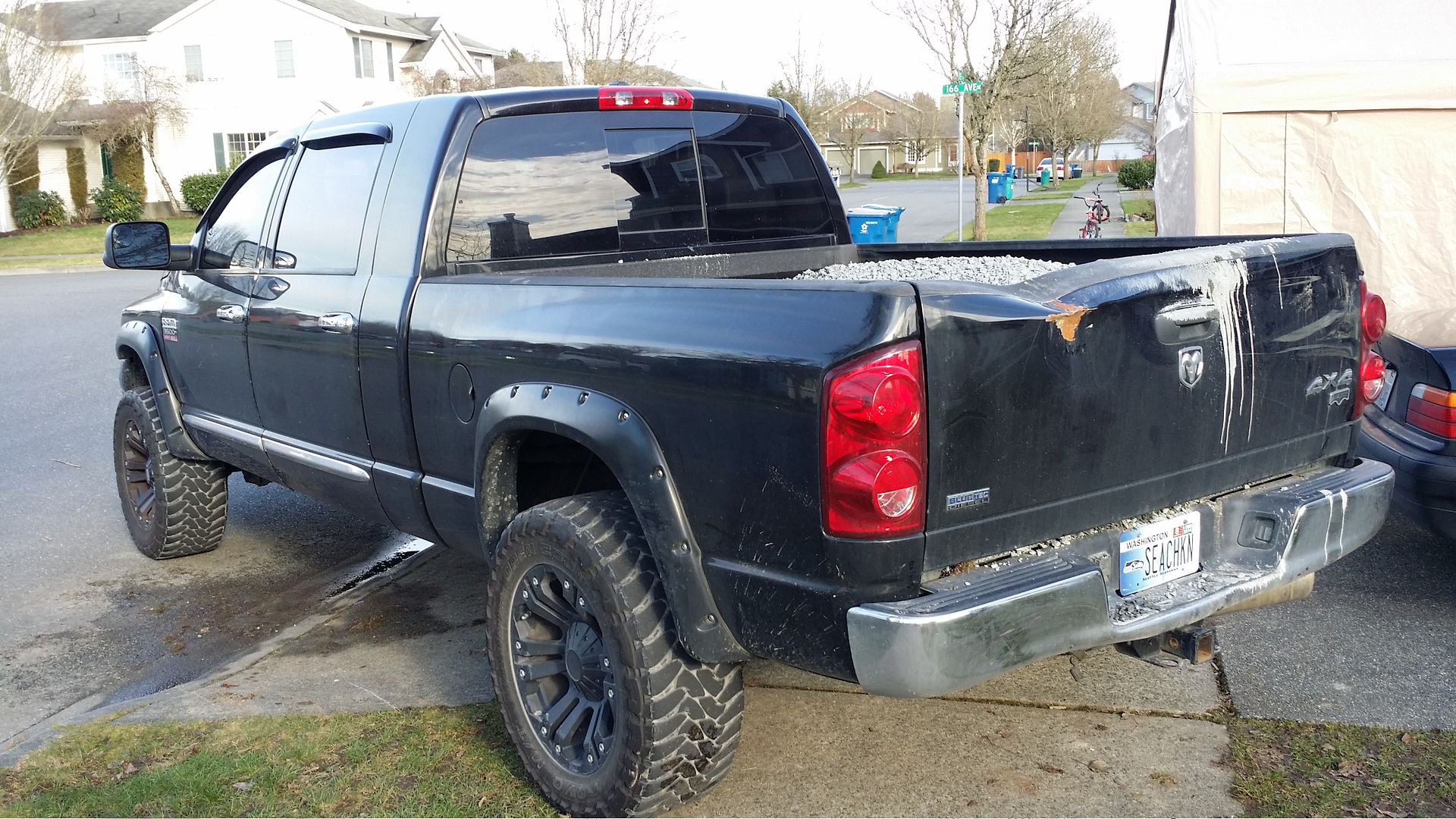

The OP has no wheel or tire worries but may need more rear spring help depending on how much payload he needs.
