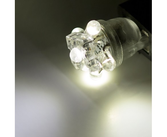

Marker lights on a Thor I have sitting in my shop had #194 lamps in it. I ended up using bulbs from SuperbrightLED to replace them.
https://www.superbrightleds.com/moreinfo/boat-miniature-wedge-bulbs/194-led-boat-and-rv-light-bulb-5-led-miniature-wedge-retrofit-30-lumens/2485/874/#/attributes/10837
They worked well for the purpose. I normally use LED's from M4Products, in fact that is all I use, but I could not find something I liked for the clearance lights and ended up with the SuperbrightLED ones. I tested them by jumpering the power to running light contacts ont he trailer 7 pin connector using a turn signal flasher and let them flash for a couple of days to prove out that they all worked. Each bulb in the link uses 5 LEDs so the light scatter under the lens is good.
