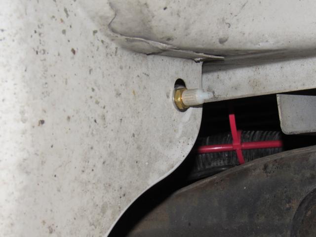

I do have auxiliary air bag fills in the rear wheel wells of my 2014 Tundra. No drilling needed, I removed a plastic rivet and used that hole. - lakeside013104ExplorerI wire tied mine to the rear bracket on the driver running boards. Easy to get at, check and air up to.

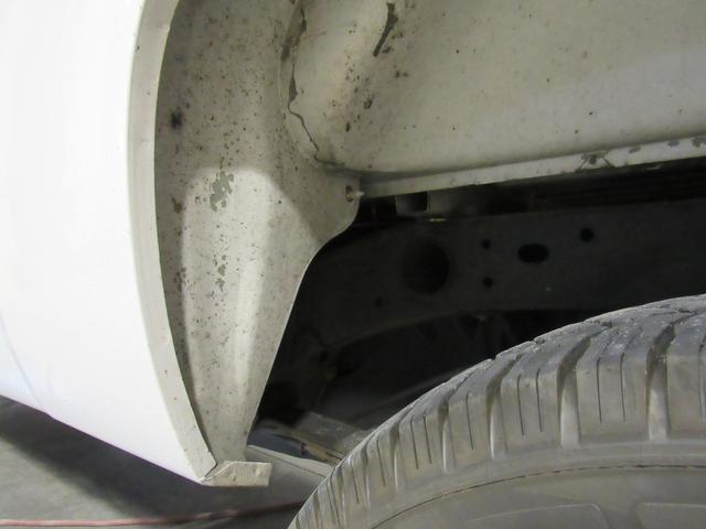

I then put them on the bottom of the rear fender behind the wheel by drilling a hole under it. This is OK, but I rather have the two valves together. There is no need to have them on both sides of the truck.
I was worried about using the inside fender well in case the tire threw something up to damage the valves poking out. I have a fender well plastic liner, so the valves would have to be inside the well…
