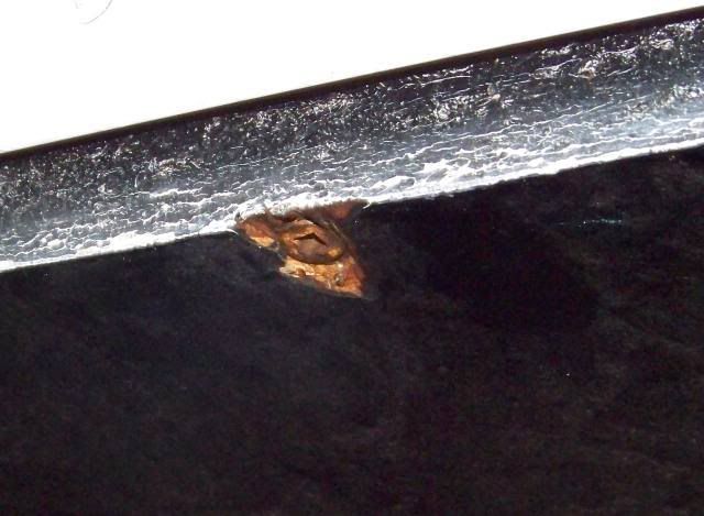

Coated slice floor was the next trail after the Darco. See here, This is a thick plastic bonded to the OSB board. The issue is water separates the ends and any chip in it pending where it is, can be an issue.
The coating advanced to this

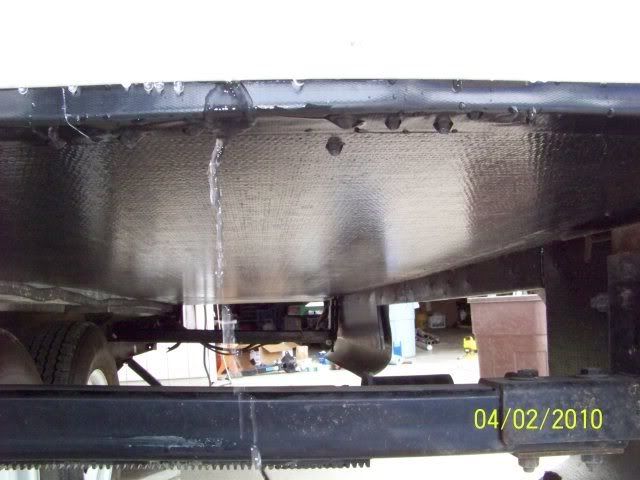

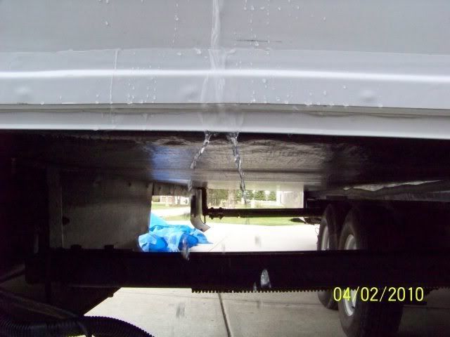

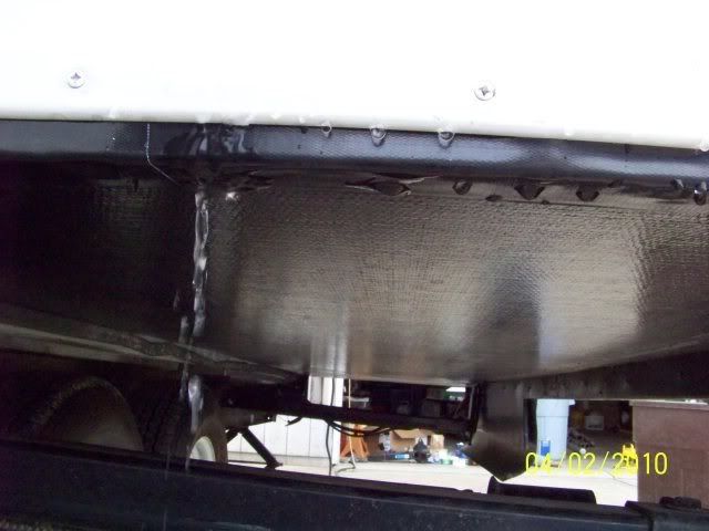

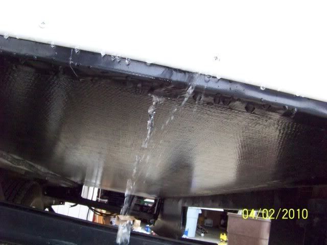

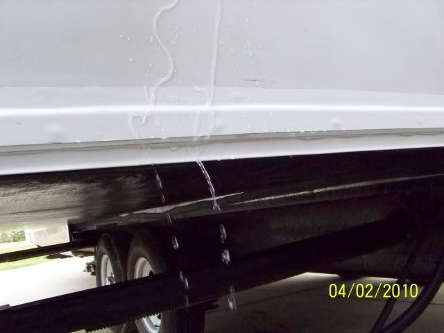

Regardless of how you do this, A drip edge is a must in my book and no exposed holes up the bottom in the membrane.
Here is the problem. No drip edge
The fix. An effective drip edge and Eternabond sealing it to the camper
