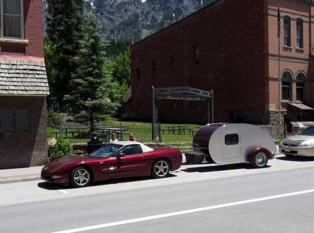

Ok, settle down now. Lets say my goal was to pull a 2,500lb travel trailer with maybe 500-1,000lbs of gear. Could it be done? I've seen images on the web of much smaller vehicles towing what appear to be quite large trailers. I'm not planning on driving up and down any boat launches and I'm content with the right lane on the highway.
