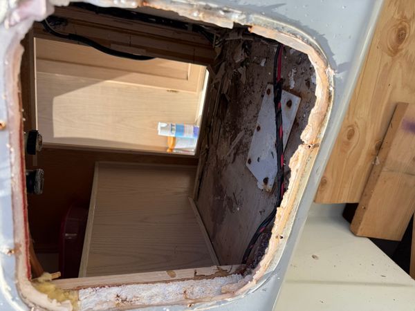

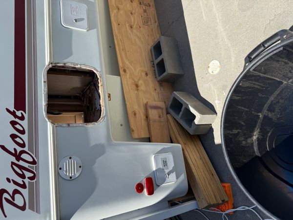

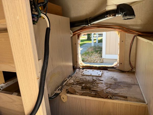

  • So I found some more light water damage in the propane tank compartment and the under the battery compartment.

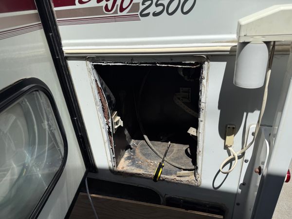

    If anyone has any tips on how to get the propane compartment out I would be appreciative.
    Id also be curious if anyone can point me in the right direction for somone who has replaced the compartment. It seems to be some sort of molded plastic/rubber unlike anywhere else in the camper and I’ll likely need to replace it as well as the door to the compartment.
    For the battery compartment I’m likely just going to put some plywood over the hole and fiberglass it shut. As I’ve switched to Lifepo4 batteries and those like to be inside.
    For the bottom of the camper I went ahead and got new and improved insulation and went with an r8 insulation which should hold the heat and keep it cool better. While down there I also added some insulation to the water pipes.
    • StirCrazy's avatar
      StirCrazy
      Moderator
      for your battery compartment, why don't you get a normal insulated door and put it there, that would let you load and remove batteries from the outside
      StirCrazy
      Moderator
      that propane compartment should just be a steel liner that is slid into place from the outside then anchored down.  I would Imagin if your carful you can find all the fasteners and then just pull it out
      • FreeMotivation's avatar
        FreeMotivation
        Explorer II
        It's not metal, the inside is some sort of rubberized material that is flexible. Do you know where I could purchase a metal compartment?
      FreeMotivation
      Explorer II
      No the warped panels were the what was covering the water tanks. They are slightly deformed I think I could fix those easily,
      I am more worried about that wood that has black marks and is very brittle to the touch. Do you think the repair needs to be made now or can it wait?
      Is there anything else I should look for while I am in there?
      Thanks for your time!
      • Grit_dog's avatar
        Grit_dog
        Navigator III
        Pictures don’t always tell the whole story.
        But black = mold or mildew…whatever. Spray it with some diluted bleach or something. It’s an old camper.
        If it’s rotten or cracked, repair or replace it. Bout all I can say in general.
        Can’t say what repairs may or may not be needed. But from my limited TC experience fixing busted tank straps and shoring up the base area a bit, most all the support for the camper comes from the perimeter. Anything in the middle is mostly holding up the tanks, at least on the old Arctic Fox I worked on.
        Ultimately I used a bunch of 5/4 cedar decking to cut into some additional support and bearing area.
        can’t say eggzactly what your camper needs.
        But it’s one reason folks warn to generally not “use” the camper off of the truck or fill the tanks without some support under the bottom of it.
        I did it for years though, only to have to do a little fixin on it. Not a big deal.
