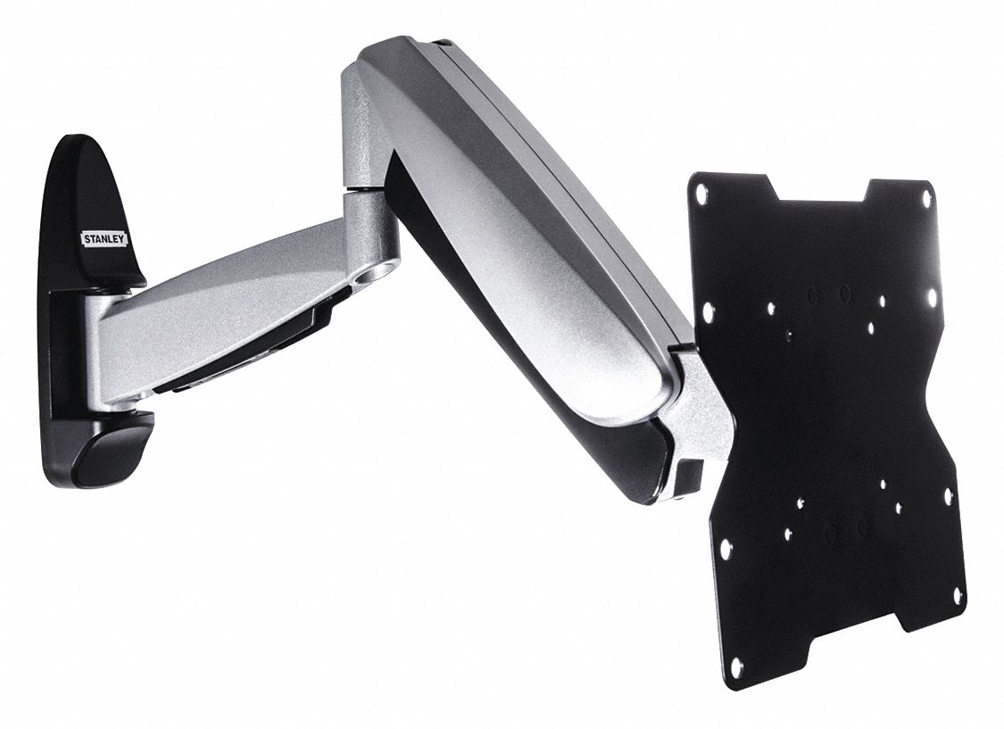

  • Get a "full motion" mount. They go anywhere you want them, even up and down. Here's a link but that seems high for one. I didn't pay that much. Try monoprice.com for a better price than this one:
    LINK
    I put a wire between the top two holes so when we travel, it hangs on a hook. When we use it, we lower it right down over the bed. When we're done it swings up and to the side. Love it!
