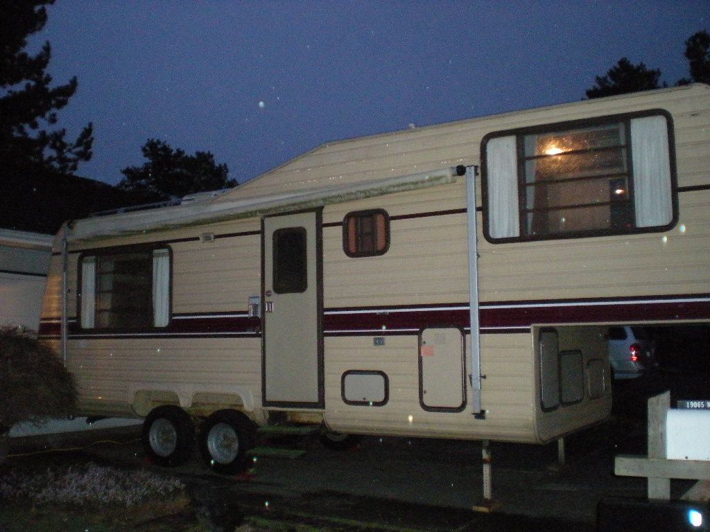

What sort of options do I have to help level an older fifth wheel with a newer truck? Pic below - is that too far off level? The pin is sitting on an Anderson at its lowest setting. I've only got about 5" between my bed rails and the trailer so I'd love to move the hitch up a notch, but that makes it way out of level.
It needs new tires and I think I can gain about an inch and a quarter there but I'm wondering if an axle flip or some sort of lift kit may be necessary. Any input is welcome.
