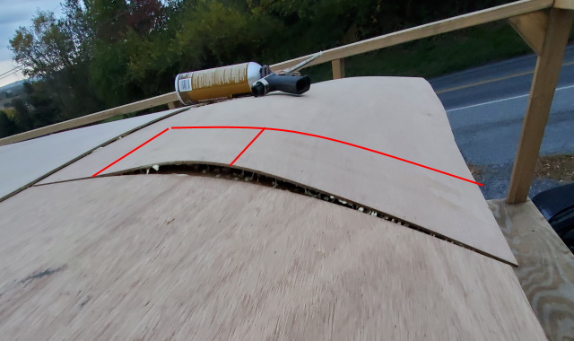

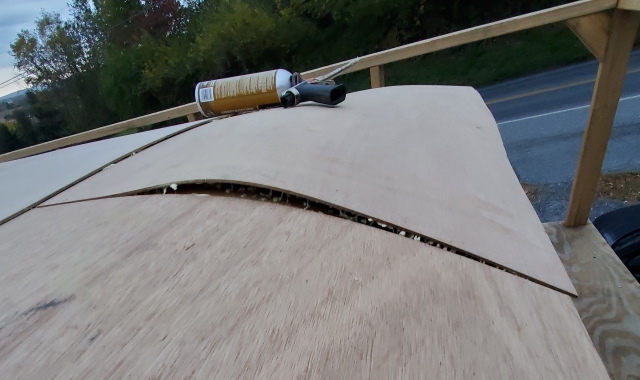

- Had to fix an "oops" today. Plywood will generally bend in one direction, but not 2.
The back of this plywood bends slightly down towards the rear of the coach, as well as bending towards the side.
So, since the adhesive was hard, I cut this out in 2 pieces, as shown by the red lines.
You talk about being tough to remove the adhesive? Wow, such a scraping and cutting trying to get it all off was definitely difficult.
I hope I'll never have to remove any of that stuff (adhesive), again. Johnny G1 wrote:

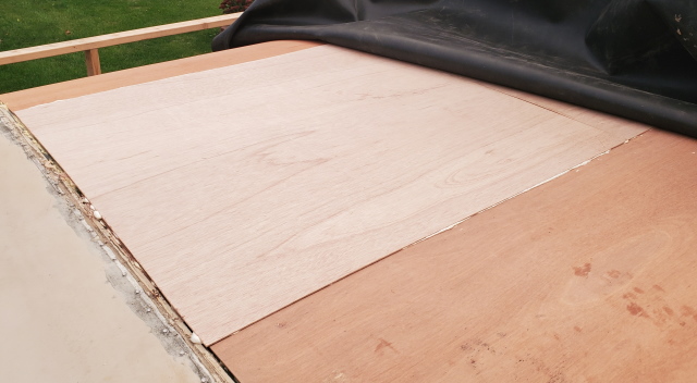

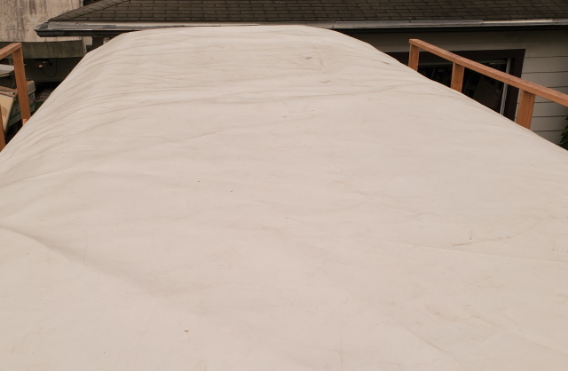

- Finally late today the weather cleared up, the sun came out, so I went up on the roof and removed all my weights, and this is the last piece of plywood in the center, which is now glued into place.
Wahoo!
I still have a couple of minor things to touch up before gluing the TPO down, but the bulk of the work is done.

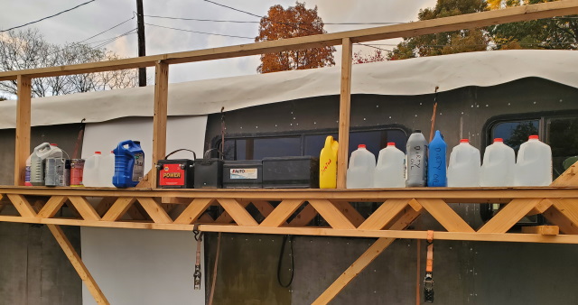

Here are all the weights I used for holding plywood down.
Batteries, oil, water jugs, paint...
You can count all the pieces so you know what to use. LOL!!!
