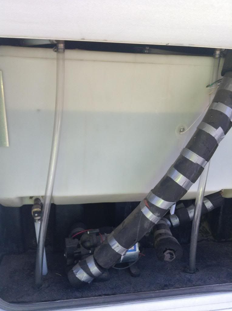

Refilling fresh water tank when dry camping
Ok. We ran out of water again this weekend while boon docking up in the mountains. I am wanting to purchase a few water containers and a pump to pump into our fresh water tank. Our current MH does not have a gravity fill. Only a hose bib connection to fill the tank. Through a little research, I found the 7 gallon auqua tainer by reliance. I'm just not sure what kind of pump to get. I'm leaning toward an AC pump and just using the generator while filling. Do I need a self priming pump? The auqua tainers have a port in the cap for a spigot. I wonder if I can remove the spigot, and instead adapt it to a 1/2" line to go to the suction side of the pump. If the full auqua tainer(in the back of our jeep)has this set up and is then put onto its side, water should flow to the pump without having to prime it as long as the pump is beneath the water level, right? Am I on the right track here? Some 1/2" line and an adaptor for the hose bib. Any other tips or suggestions?
Thanks,
Mark
