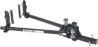

I bought this ball mount and received it on ebay. Yesterday, I was looking for the WDH. It seems that with the WDH, you don't need the ball mount I just bought. Did I just waste $125 for nothing?
I don't have the trailer yet. Just shopping needed equitments.

    It's up to you to decide if you want to keep it and maybe sell it some day, or sell it on Craigslist and maybe get a good bit of your money back. Some setups don't require WDH but trucks with travel trailers normally do. The idea of the WDH is to replace the weight you remove from the front axle when you apply the tongue weight of the trailer. You will definitely need the WDH for your trailer.

    Send that ball mount back and get your money back, it's not for WD. WD hitches come with the ball mount.
  • Also, you'd be much better off if you purchased a WD unit that has sway control built in...such as the Reese Dual Cam or the Equal-i-zer and if you're really serious about having absolutely NO sway you can look into the Hensley Arrow or Pro-Pride.
    Getting a WD unit without sway control is only doing half the job as now you'll have purchase the small friction sway control bars that are only marginal at best.
    Research, research, research....

    Sorry but yes, you probably wasted your money. The "ball mount" (also known as a drawbar) will come with the new WDH.

  • You wasted your money, but maybe you did not. You may find the hitch you purchased useful for another trailer someday, especially if it has a different size ball than your camper. I have 4 different hitches and about 6 balls, used on different trailers.
    About the only that may work is the Anderson. But it also comes with the hitch:
  • Sorry but yes, you probably wasted your money. The "ball mount" (also known as a drawbar) will come with the new WDH. It's very specific because the spring bars have to attach to it.
