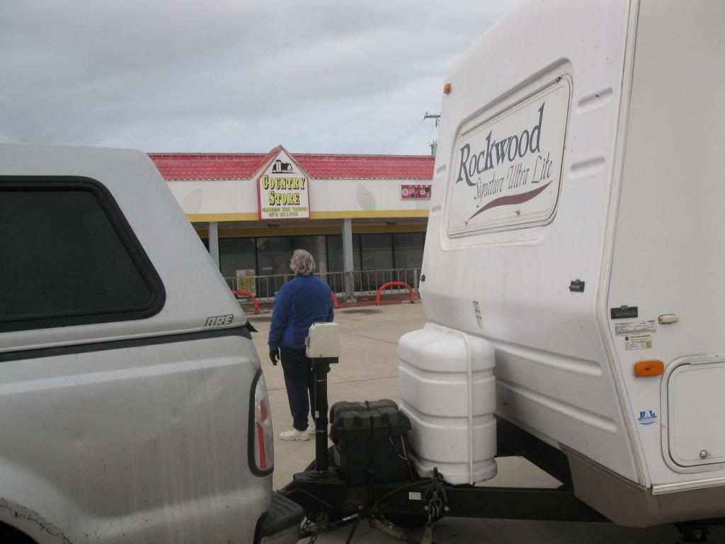

I got into a discussion recently that got me thinking about a few things and I want some group thoughts.

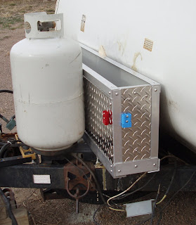

In my TT (in sig below) I have a full pass-through compartment, then a compartment for 2 LP bottles. There is only enough room on the hitch for one battery and in fact the dealer had to redesign the hitch to move the battery from the factory location to accommodate my WD setup. I have contemplated increasing battery potential but the conundrum of where and how to mount several batteries comes up. I have considered a 4 battery box on the rear bumper but then I have to relocate my spare and possibly remove the outdoor grill mount.
Then I came to a realization. I have considerable space in the storage compartment under the bed. Would it be possible to create a 4 battery space under there that would have enough ventilation to be safe? Granted the potential for a battery fire is always present if something should go wrong but most of us have a battery right next to the LP tanks which in my opinion is just as, if not more, dangerous. I suppose one could sacrifice part of the pass-through and put in a slide out battery tray for batteries and move some gear into the bed storage but it seems to me that in the interest of regular access the batteries don't need to be accessed and would be more out of the way under the bed.
