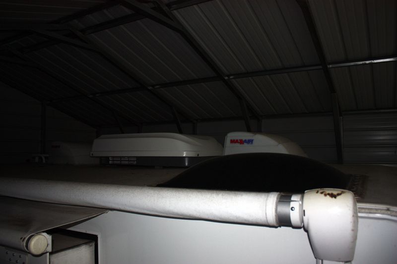

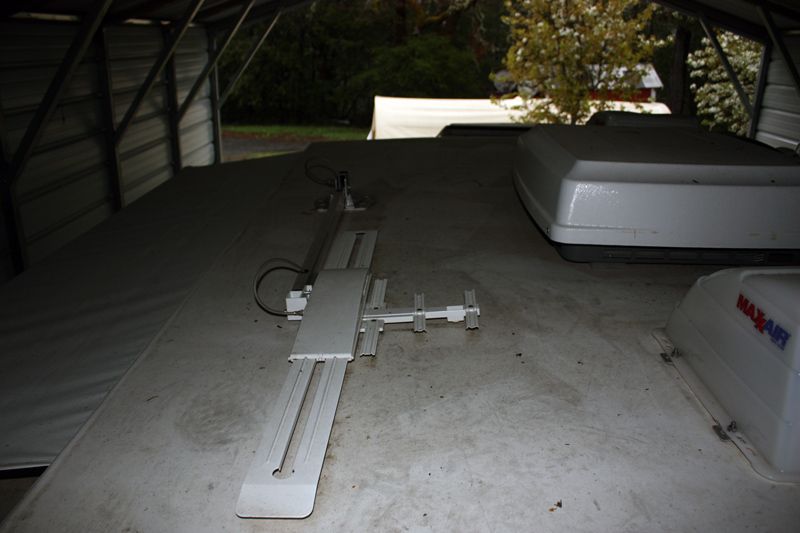

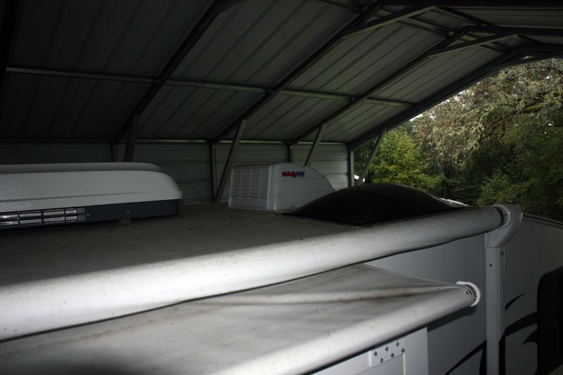

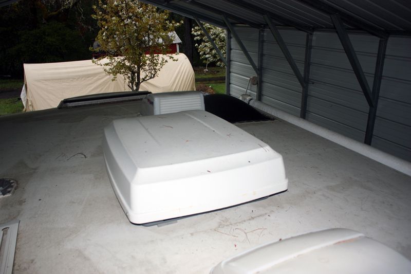

Well, all I can say is that you are wrong and I have the pictures to prove it. The only things on my roof are the AC vent,TV antenna, two fan vents and two skylights.
I have seen lots of campers and never have seen a tank vent, they may exist, but I haven't seen one. I have seen them on trailers, but not on campers.
AC, bathroom fan vent cover and bathroom skylight.
Same thing different angle.
Other side, nothing but AC and antenna.
Another angle, AC, bathroom vent cover and bathroom skylight.
