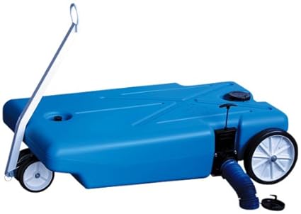

Different Ways to Empty a Waste Tote?
I have a waste tote that requires it to be stood-up vertically to empty (via gravity). After filling it with my macerator, this waste tote weighs 250-300 lbs. when full---just way too heavy, cumbersome, and unsafe to stand-up vertically to drain it while it's in the bed of the truck.
I rigged up two input assemblies for the generic macerator I use. One to empty the black/grey tanks using a 3" RV waste connector. A second one comprised of a hose and 18" long, 3/4" PVC pipe. Use it with the macerator to feed off the bottom of the waste tote to empty it while it's in the horizontal position.
Curious how others empty larger, heavier waste totes from the bed of their truck, especially Flojet owners who only have the 3" RV waste connector to work with.
