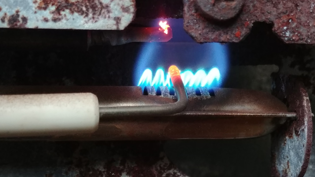

I have a 2011 Keystone Cougar 328 with a Dometic Refrigerator.
The Freezer part seems to be cooling fine, but the Fridge might get down to a temp of 70. very minimal cooling. It also only seems to work on Gas.
I replaced the main Circuit board. and no change.
The Heating element is giving me a 44 ohms rating.
I have a new Thermistor, but haven't had a chance to install yet.
I did notice that the upper circuit board, If I touch the power switch just right it error light pops up.
I assume I will need to replace the upper board as well. Is there a good way to test this board?
I did read to check for an obstruction by taking the roof vent off.
I do have a very serious dirt dobber / Wasp problem in the summer time around my property.
Just looking for any other thoughts.
