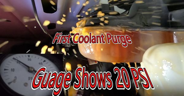

Watch My DeGas Bottle Blow Coolant
VIDEO: 6.0 liter PSD degas bottle blowing coolant
Here's video from under the hood of the F550 showing the degas bottle and coolant pressure gauge. You can watch the coolant level go up and down to the sound of engine RPM. The degas bottle blows coolant 6 times in the video. I drive I5 at 62 to 65 during the test. Temp varies from 186 going down hill and as high as 198 going up hill. Flats about 190. Coolant pressure typically 16 to 18, and tends to blow out coolant at 20 psi combined with temps over 194. Pressure is fairly consistent so the likelihood of a bad head gasket is low. Temperature and control of it seem to be the problem. As you know, I've gone to considerable expense and cost to control temperature. I'm starting to install a larger Mishimoto DeGas Bottle now to give more room for expansion. Lots of people have this same issue and have installed the Mishimoto DeGas Bottle with success. We'll see what happens.

  • I would add this picture to the main post but the website won't allow me to edit the post, so here is a preview as the first and only comment.  I guess there are few.6.0 liter owners or.the topic just isn't interesting.
    I will be installing the Mishimoto degas bottle tomorrow, then give a drive test. Hopefully the greater volume will provide the additional expansion volume to end the coolant purges.

      I applaud your videography skills, super cool, but **bleep**…
      Pretty $cary looking especially considering it’s not bulletproofed (studded).
      Hope for the best for you but that’s a lot of pressure variation despite your optimistic outlook
      If you plan on keeping this thing, I’d check for combustion gasses and do the glove test first
      You’re too far into this truck now to deny the issues and head studs are cheaper now compared to after the heads liftoff.
      Remember, you’re not even working it in the video. Driving miss Daisy at sea level  on a flat road in cool temperatures with no big load on it.  My 1974 Jeep with the original radiator can handle that without breaking a sweat, or popping the 25+ year old radiator cap.  And that’s flat out  top speed white knuckles in that thing.
      I know I’m being a bit sarcastic but especially after everything you’ve done to keep it cool, it’s cool but it ain’t happy in that video!
      I hope you’re right and I’m wrong, but the reason they make aftermarket degas bottles for 6 leakers ain’t because Ford used cheaper plastic than everyone else.
      • Camper_Jeff___K's avatar
        Camper_Jeff___K
        Navigator
        The 06 07 have the larger 20mm bolts so less susceptible to the head and gasket issues. If there was a head gasket issue I'd see gradual exhaust suit buildup in the coolant, that hasn't happened. Two theories are the heater hose supplies more coolant output than the 1" return line can take in and so coolant backs up into the degas bottle and blows. Another thought is the truck has been serviced by a Portland dealership many times over the years. Perhaps a rag or some item was left blocking a passage. It would not be the first time. The purging does seem more temperature related. Watchi g the pressure gauge, it really doesn't change much but the temperature does.
        It's a very low mileage engine, 90k, and very clean inside. When I replaced an injector pulling the left side apart,  it was one of the cleanest engines I'd ever seen. Love the truck, it does a fantastic job carrying the TC and is super comfortable to drive. If I have to, I'll install a set of KD ICON heads and inspect the internals. I could put another $30k into this truck and still have it for less than a new F550 without all the def dpf and electronic monitoring on it. It's a few days job I can do so no problem.
        Whatever is going on in the engine, it will eventually be figured out and then I'll share the cure with people and they will benefit.
