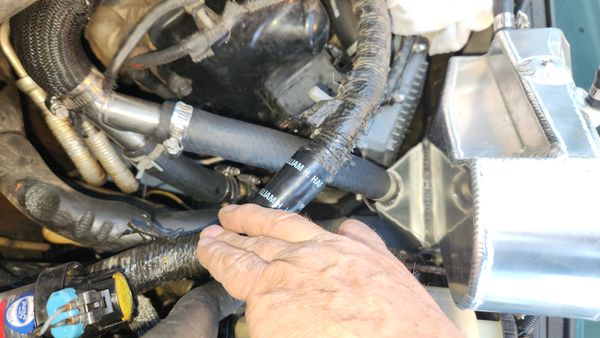

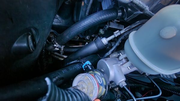

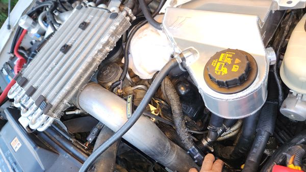

    In short, I installed the Mishimoto degas bottle, not going to bother again telling how I found it is actually smaller than OEM in volume, details might make it not post again.
    Not going to mention how replumbing with larger pipe is probably the biggest contributor to the success. I'm now enjoying.
    So yes, Problem seems to be solved but if I mention details, the post might disappear.
    I tried hard to force a coolant purge and it didn't happen, temperature never crossed 192.
    Oil 202.
    DeGas bottle with return to factory hose connections and coolers for top of engine EGR degas hose to degasPlumbing with larger hose and fittings
    AC with electric fan on condenser.
