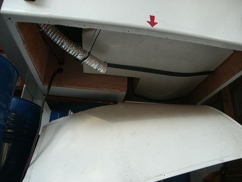

Bigfoot owners, Does your camper have this bottom panel ?
I just completed a lithium upgrade. Having access to the underside was great. But I am wondering if this is on all bigfoots. The bottom of our 9.6 is cut out and a white plastic sheet was screwed to the hull. There are two panels, a front one and a back one.
Interesting to find the 50 gallon water tank suspended by seatbelts. Able to be rocked to and fro a little. The manual claims structural damage by filling to fast. I did that once and feared the worst. Seeing the suspension system was a relief. There are no structural members to fracture. I do not believe the tank has been removed or replaced. The webbing screws are on top of the tank impossible to reach. That is a LOT of weight to hang from straps.
Anyway, just wondering if other Bigfoots have this cut out and white covers.

    The removable panel on the bottom of the Bigfoot would only be a problem if your pickup bed had a watertight liner with no drain holes, and you parked on a serious downhill slope. There is no need for the rest of us to seal those panels.

    And yes, I too had the 1 inch styrofoam bottom sheets. I put them back before closing it all up. I did not use any sealant because I did not find any. I know water will not pool in there or migrate else where. The one good thing about no sealant is if you have a water leak, you will sure see it. I don't think water intrusion would be an issue. It does not need to float thankfully. ;) I am still stunned by the carelessness of the cuts. A simple line to cut would have left a really nice end result. That and a 1/2 sanding drum to radius the inside corners of the cuts would even have the benefit of greatly reducing the potential for fiberglass cracks later. I am kind of a perfectionist with that kind of stuff. I do metal work on cars so I like the little details. I appreciate the replies that are being posted. Hopefully we will be camping very soon. So much to do.

    As to the original question, I bought my unit new and it too has the removable panels on the bottom. I'd like to ask a question of my own on that. For those who have removed it, what did you use to seal when you replaced it?

  • most of the ones I've opened had sheet1" foam on top of the fiber glass /plastic pannels
  • Interesting and I am not surprised on the screws. I found a half dozen screws holding things like wire run clips only half way in. Sawdust, dropped screws, plastic shavings, all kinds of debris that would have taken ten minutes to vacuum up. All in areas that were not readily visible. Like behind the power center. The fit and finish inside the interior is beautiful. As to be expected. However comma If you look closely at the cut on mine, it is terrible and wanders all over digging into the framing and drifts back out into open air see sawing back and forth. Look at the outside corner on the basement there and you can see a big fiberglass flag missed by the saw. The cut was done so poorly I wondered if it was a factory feature. Actually that is one of the reasons for this thread. At first I feared a breakage and a repair. Glad to hear this is a standard thing.
    A simple grease pencil line would have done wonders. I was not impressed. Bigfoots are indeed great campers, but they too have issues I see. Maybe it was a finished on a Friday.;)
  • My 9.4 has a panel like that. Found my water tank barely secured. It had two steel angles under it, both with screws only half driven. So much for quality control.
  • Yes they do, depending on model. My 9.6 had panels similar to yours, the 10.4 I have now has one large panel further forward giving access to the tanks, and a small one on the side of the box all the way forward through which you can access the shower drain plumbing. The tanks are suspended on nylon webbing.
    The concern about filling too fast is the air cannot escape fast enough and the tank will swell, breaking it or its fastenings. This is true of most RVs, not just Bigfoots. It takes only a few psi on the large area of the tank bottom to produce a lot of force.
