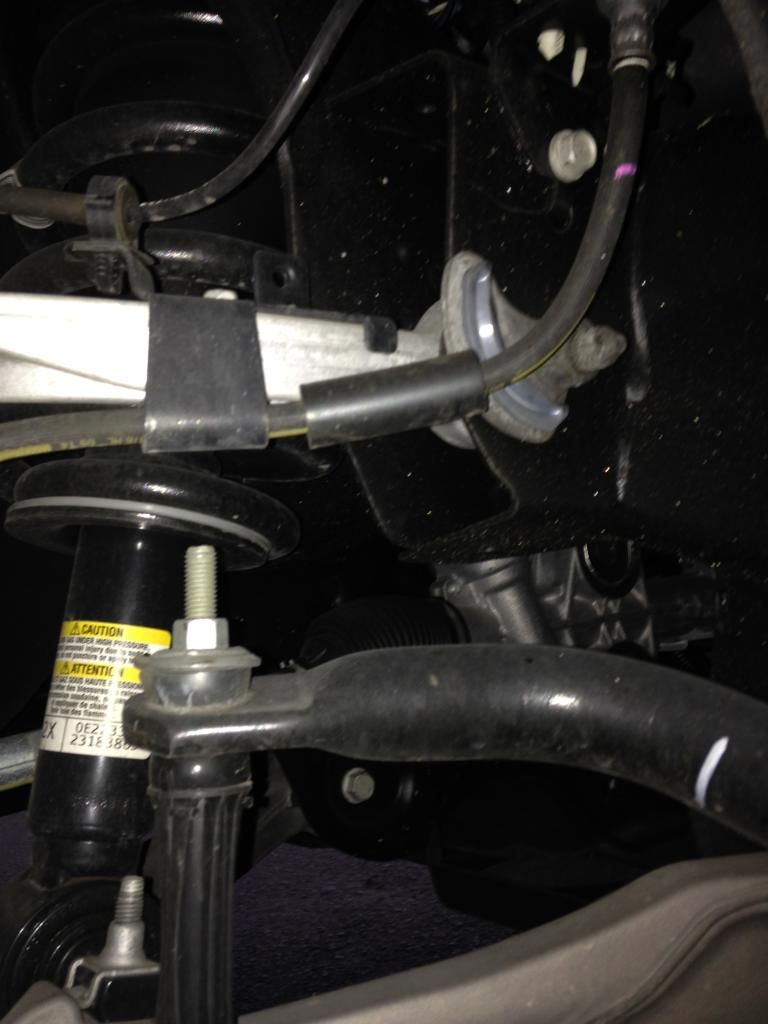

Here is a pic of the lower a-arm.. pretty beefy
Here is a shot where you can see the upper a-arm and the sway bar, again, pretty beefy
