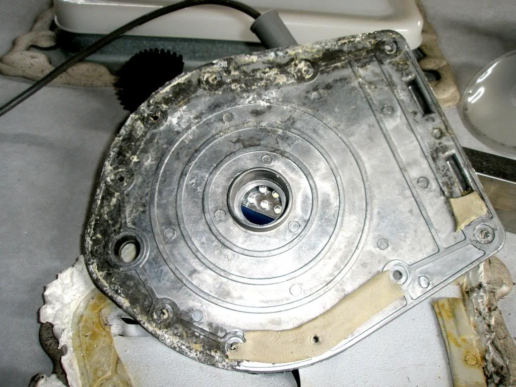

Do a google search on "lubricating a Winegard antenna" and you will find plenty of information. - LynnmorExplorer III found missing seals, poorly installed cable boot, useless putty tape, stripped mounting screws and caulk that wasn't sticking to base. In the photos you will find a garage kept trailer, one year old that hadn't been in the rain more than five times. My suggestion would be to pull the antenna and start over so it can be done right.
Photo - azrvingExplorerAs said, check and seal any dicor. I had a leak in the antenna area and it ended up being the boot. It looked fine but was just not tight enough on the cable. I never would have believed it could leak that much but it did.
