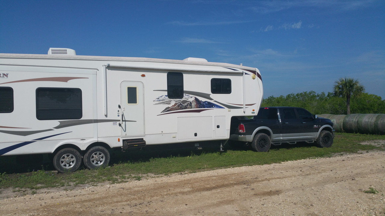

  • ShinerBock wrote:
    BTW, my old RV was 14k loaded and this is how my truck looked under it. Pulled it the 160 miles trek back and fourth from Rockport for several years. Although this was before I leveled my truck and I don't have any air bags or helper springs. Rear suspension is 100% stock.
    What kind of steps are those? I'm generally not a fan of steps but my wife and kids have been on me about them since I bought this truck, and those look like pretty good ones. I like the third step back by the bed.

  • BTW, my old RV was 14k loaded and this is how my truck looked under it. Pulled it the 160 miles trek back and fourth from Rockport for several years. Although this was before I leveled my truck and I don't have any air bags or helper springs. Rear suspension is 100% stock.

    Not saying the 2500 can handle as much as the 3500, but what it can safely and reliably handle is pretty darn close from my experiences. I have had over 3k back there and it handled like any 3500 and only squated enough to make the truck level.
