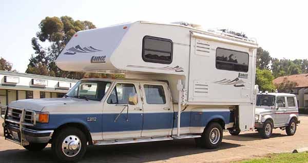

I have a cab over camper on my crew cab F350. When I have it on the truck, I loose XM reception. Is there an extended antenna that you could install to connect to a ford radio?
cubbear wrote:
on my 2015 F350 XM plug down by steering column I bought extra antenna & plugin from ford and mounted in front of windshield on drivers side works great. there is article somewhere that shows exactly what to do
