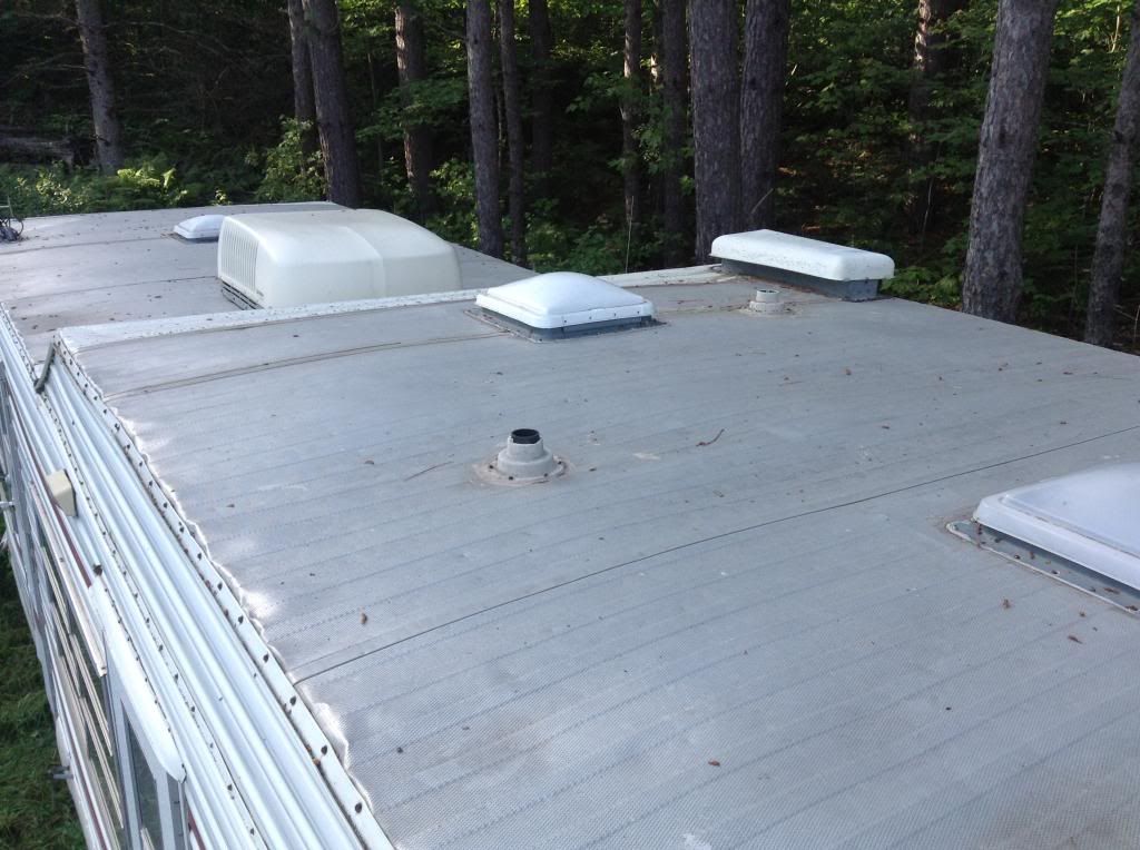

So here it is! Snagged this for 400$, "only a little water damage" the P/O said.

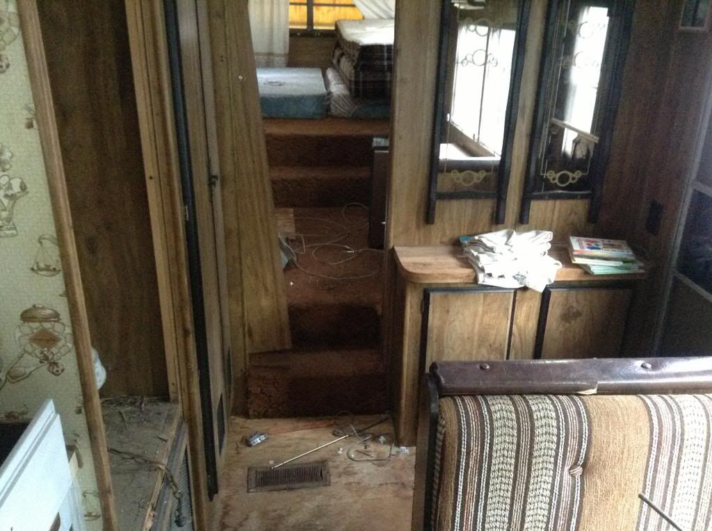

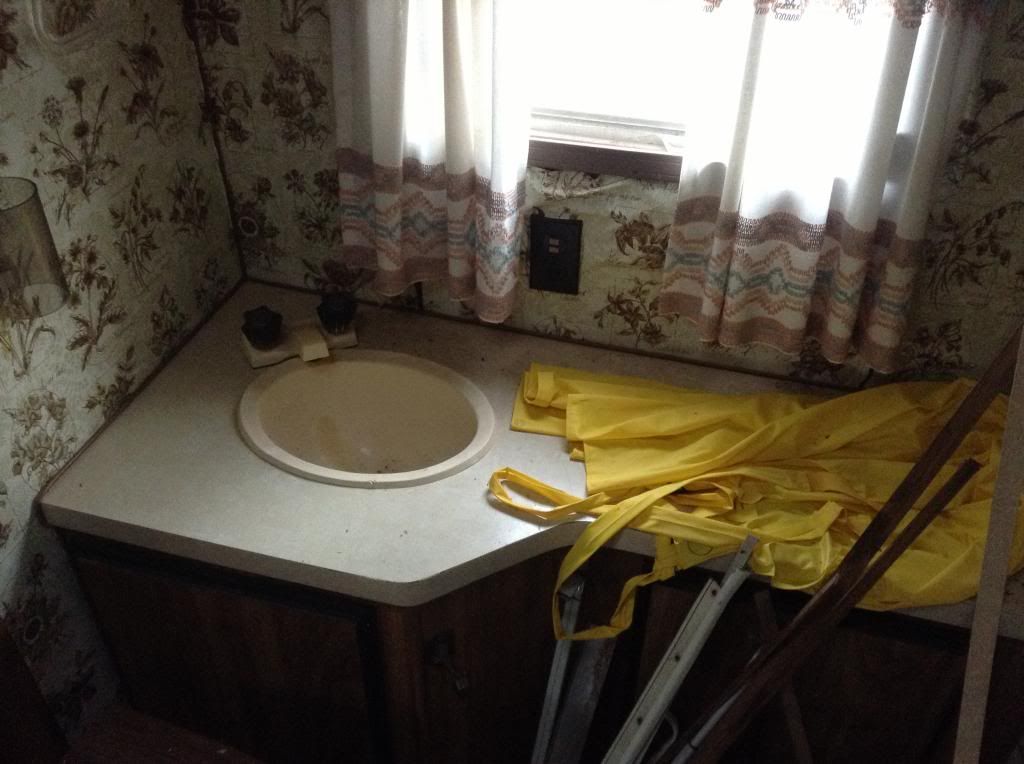

Got started on ripping out some of those nasty cupboards, and wow, this thing sure was a rotten turd. Walls were mush, like wet cardboard.
Floors were solid so far, so I ripped everything out of the living room & kitchen areas, so I could put down some half inch OSB for a thicker, stronger subfloor. I dont like feeling the floors flex under my feet! Over top of the OSB I'll be putting laminate flooring later on, with that blue underlayment.

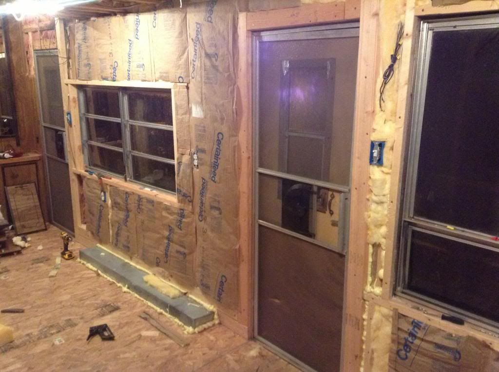

I also didnt like the idea of the walls being stapled 2x2s, and since I had plans on camping year round, why not go with 2x4 walls? So I doubled up the old 2x2s where they were still rot free, and completely tore out sections that were gone and framed those in with 2x4s. I am in no way a carpenter, so it might seem kind of redneck, but hey, I can hang from those walls and I'm 200lbs! Way stronger then factory.
You can see some random places that previous owners had "repaired", makes me feel good about my work, lol. I could move these walls in and out 6-10" they were so rotten.
I started insulating the side I finished with R13, just to give myself something different to do. Pulling down rotten wood and soaking wet insulation gets pretty tiresome.
