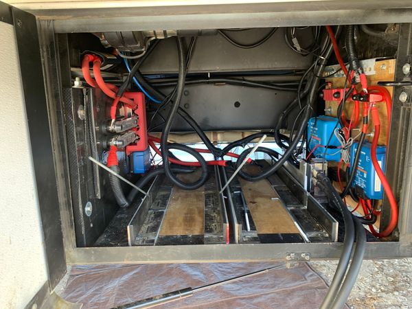

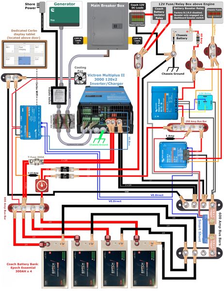

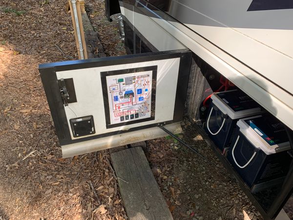

    I did a lifepo4 conversion on our Newmar class A as well.  Took over a year, and still tweaking it, but it’s been amazing what lithium batteries allow us to do.

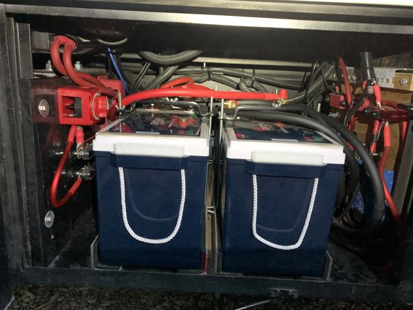

      I ended up also having to tear out and completely rebuild the battery compartment from scratch.  Replaced the 6  6 volt gc2 batteries that came from factory with 4 300 amp hour epoch essentials.  Wired it using bus bars, two Victron DC DC chargers for charging, smart shunt, multiplus 3000 120x2 inverter/charger, and cerbo GX for monitoring.  It is soo cool being able to run literally everything off batteries and camp off grid for several days at a time when we want.  The monitoring Victron allows with their VRM portal online is amazing, too.  Ended up buying an Amazon fire tablet, installing cerbo GX software on it and using it as a dedicated cerbo gx monitor.
    Next step is to add solar panels on roof, although not sure if we will.  Very happy with the rig as it is.  We can run everything off batteries and be off grid for several days easily.  can even run one air conditioner off batteries for about 7 or 8 hours before we have to crank up genny or plug in to shore power to recharge.
    Here are some pictures:
    battery compartment:
    Here’s what it looked like without batteries in it (this was before I added the cutoff switch):
    wiring diagram i made illustrating all of it:

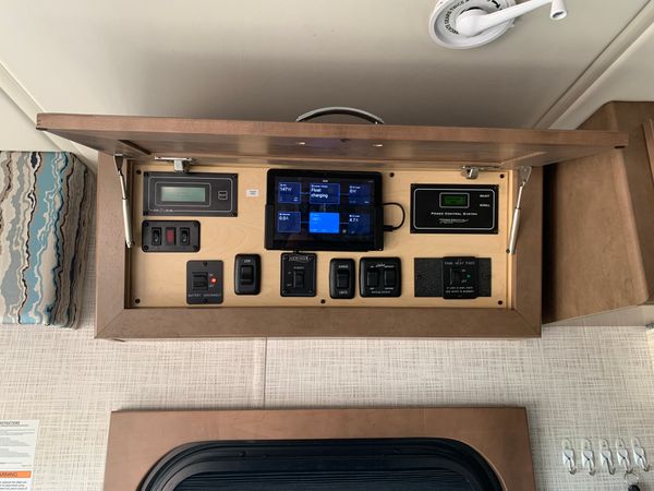

    cerbo display tablet over door:

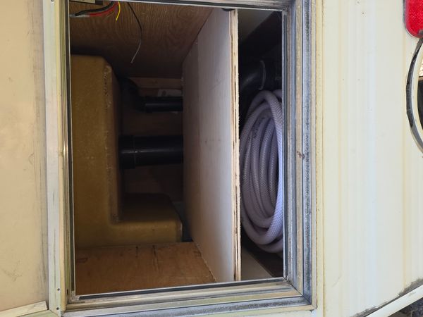

    I still need to finish the shelves with a stain/poly coating, but I wanted to get it out this fall and make sure the placement of the shelves and the 1/2" plywood thickness is all good first.
    also got a shelf built in the outside storage compartment to go over the plumbing pipe and allow me to put smaller things under the shelf, and bigger things on it.

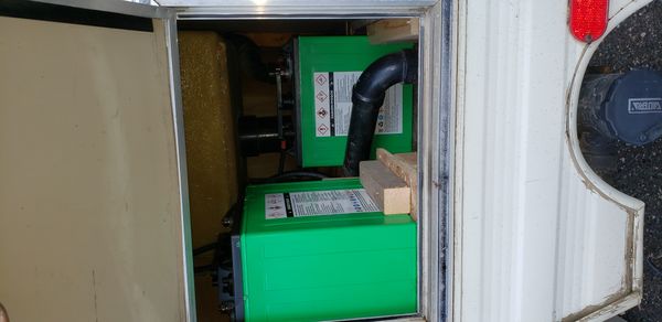

    this was the storage compartment when it originally was turned into a spot for the two 6V batteries.
    Now .   the front half of the shelf is removable, I had to cut it in to two pieces to get it in so the back piece is screwed down and the front just floats so I can get better access to stuff underneath

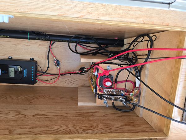

  • well, got a bit more done before it go to hot to work outside.
    I had to pull everything out again, as I forgot to run two wires to that area the batteries were in to power my LED backup lights.   I also wanted to put in a USB charger solution so we could charge our phones, and what ever else quickly, and with out having to run 10 foot cords through the sliding window of the truck to a charge port in the truck.  the joys of a 34 year old camper eh.
    I couldn't get it where I wanted, but I found an area that will work.  it is just behind the back of the shelves by about 1/2" so it was a perfect place for it.
    then I proceeded to get everything back in the closet, move the solar controller and clean up some wires.  this morning I am going to start on the shelves in the closet.  by freeing up the outside compartment, I will be able to put my stove and griddle out there instead of in this closet so that is the trade off.  I end up with about the same storage space in this closet but my cooling stuff goes outside.

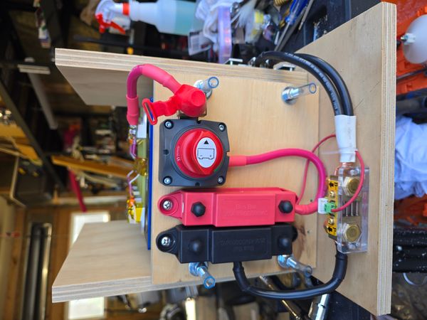

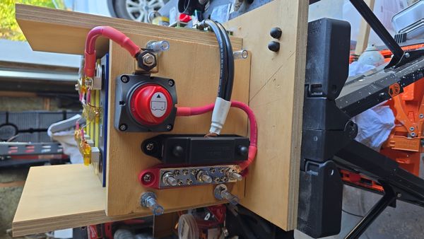

  • I got off my procrastinating butt and wanted to get the camper ready for some fall camping now that the 5th wheel trip is over.  that means I had to get this new battery tested and installed, but first I had to add all the accessories like cut off switch, fuse, busbars and get everything mounted.

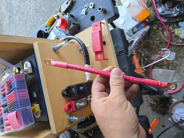

    had to make up a bunch of custom wires.
    First solution, then I realized the shunt for the battery meter was still mounted in the camper
    new mounting solution

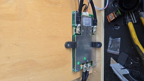

    one of the things I struggled with was finding something around the house to use to mount the BMS.  then I remembered there were rubber feet on the old 5th wheel water pump that might work.  two of them worked perfect and held it more secure than I could imagin
    set in place and temporarily hooked up just to make sure everything is working properly, which was a good thing as I remembered I forgot to run two wires from the new battery location to the old one to power my back up lights.  so once I do that I will move the solar controller to the bottom right hand side, build a cover then a shelf on top  I am still deciding while I am at work this week, if I should cut the battery cables and put new ends on them or if I should coil them and secure then under the base so incase/when I sell it and want to put the 6V batteries back.
