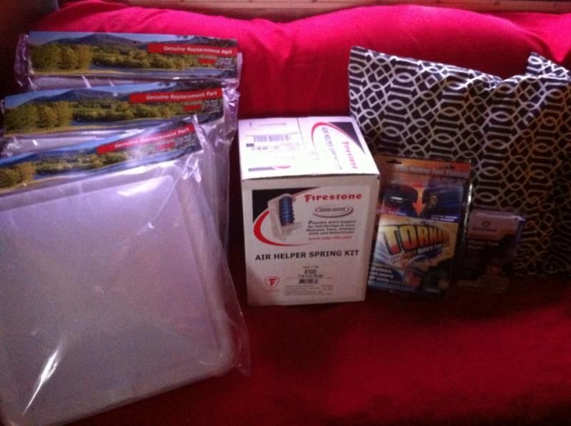

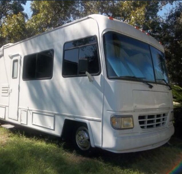

We have a 96 A Class Hurricane sitting on a Chevy p30 chassis. The front has always been slammed to the ground and without auto levelers we've had to shim up the font wheels on thick boards to lever it out when parked. Finally I got around to ordering the air spring kit and was curious if anyone has any suggestions. First off I haven't a jack to lift the font to decompress the spring but I do have enough room to scoot underneath to work. Is it possible to install these with the spring compressed? If I get the air bags installed is it ok to inflate these to raise the front off the ground or dose the front need to be up before inflating the bags?

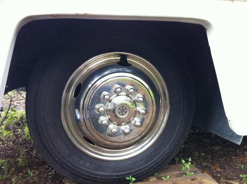

    Oh man, I hope it raises it just a little. I said it was slammed but maybe perhaps it isn't that low. We have the RV loaded down with weight. The old coil rite bags that were there were so brittle, all I had to do was put my fingers in the coil and pull out pieces and chunks. Here is a close up pick of the front tire. Most RV's that I see ridding level, you can see at least over top of the tire through the wheel well. Thats where I'd like to see ours right now.
  • The P30 front coil air bags were not to "raise" the front end. They are Chevy OEM required equipment to RAISE the front carrying capacity and keep the front end suspension in correct alignment. They are not there for ride comfort. IF your front end is too low in front, you may have weak coil springs also. You do not have to raise the front to inflate the new bags. You WILL need to get the front end up higher to change the bags. Doug
