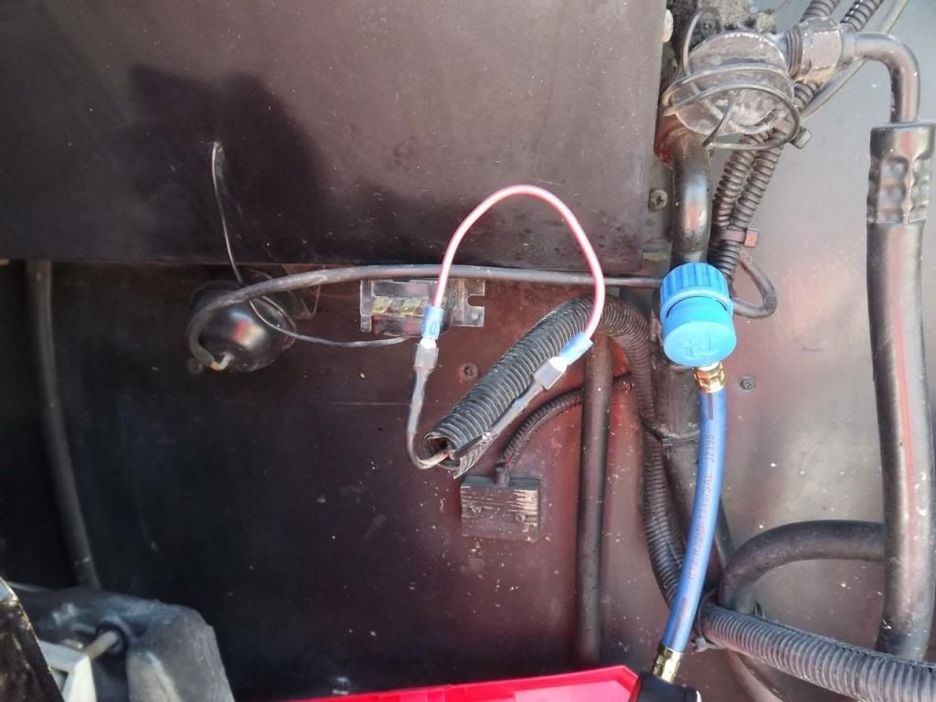

Any air conditioner experts out there? My dash air was operating just fine until a couple of days ago. Here's the deal. I start the rig and turn on the dash air. I can hear the compressor pull the engine down just a bit like usual. Soon, the air blowing from the vents begins to cool. Gets down to the high 50s (85 or 90 outside) and then cooling stops and the air warms. I watched the compressor and see it run at startup, however, after five or ten minutes the compressor starts cycling on and off, mostly off. It will run for 5 seconds, shut down for 45 seconds to a minute, run for 5 seconds and so on. The condensor fans are up front and I see they are running.
I don't have gauges but I do have a can of 134a and one of those cheapy hose/gauge deals. I hooked it up to the low pressure side and see around 40 when the compressor is running. Then it jumps way up to 90 or so when the compressor quits, back down when it starts and so onl
