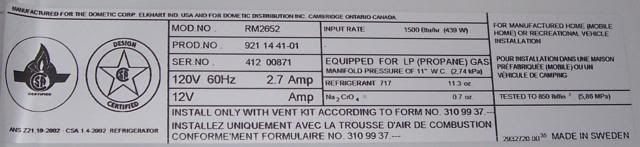

Update Number 4 Jan 19, 2007 - Recall Instructions - click here: Dometic Recall You need your model and serial numbers.

Dometic Recall NHTSA Campaign ID 06E076000
Make / Models : Model/Build Years:
DOMETIC / NDR1062 9999
DOMETIC / RM2652 9999
DOMETIC / RM2662 9999
DOMETIC / RM2663 9999
DOMETIC / RM2852 9999
DOMETIC / RM2862 9999
DOMETIC / RM3662 9999
DOMETIC / RM3663 9999
DOMETIC / RM3862 9999
DOMETIC / RM3863 9999

CERTAIN DOMETIC TWO-DOOR REFRIGERATORS MANUFACTURED BETWEEN APRIL 1997 AND MAY 2003: SERIAL NOS.
713XXXXX THROUGH 752XXXXX;
801XXXXX THROUGH 852XXXXX;
901XXXXX THROUGH 952XXXXX;
001XXXXX THROUGH 052XXXXX;
101XXXXX THROUGH 152XXXXX;
201XXXXX THROUGH 252XXXXX;
301XXXXX THROUGH 319XXXXX,
INSTALLED IN CERTAIN RECREATIONAL VEHICLES AS ORIGINAL EQUIPMENT AND SOLD AS AFTERMARKET EQUIPMENT. A FATIGUE CRACK MAY DEVELOP IN THE BOILER TUBE WHICH MAY RELEASE A SUFFICIENT AMOUNT OF PRESSURIZED COOLANT SOLUTION INTO AN AREA WHERE AN IGNITION SOURCE (GAS FLAME) IS PRESENT.
