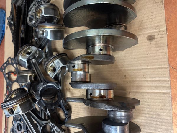

    I was able to find a 2005 used engine & transmission combo on Marketplace for a great price. I separated the two and redid all of the seals & gaskets down to the bare block. I did not touch anything in the rotating assembly (camshaft, crankshaft, main caps, piston rings, etc). I did look at the #10 rod cap & bearing and I was happy with the condition of the bearing for having 180,000 miles on it, so I ordered two new rod cap bolts, put it back together and called it good.
    Long story short - got the used motor all sealed up, replaced in motorhome and it is driving again.

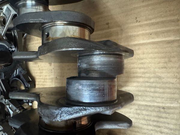

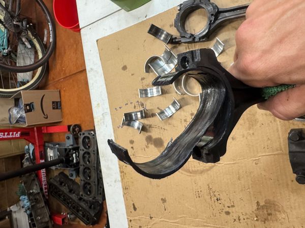

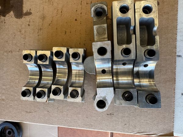

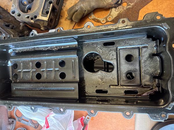

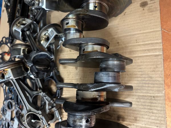

  • Here's an update after the teardown and some history.
    I bought the RV with 17,000 miles on it. Did an oil change around 19,000 miles with OEM Ford filter. I don't recall what brand was on it before, but it wasn't OEM. The engine seized at the 21,000 mile mark.

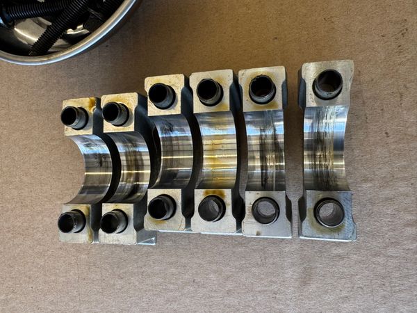

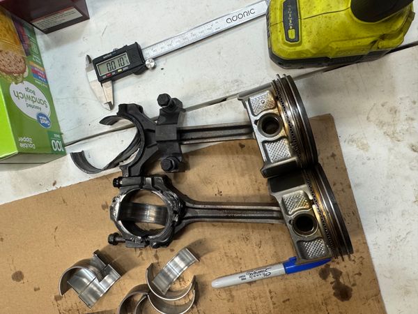

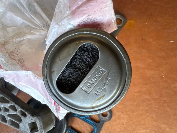

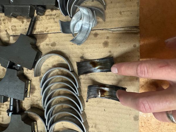

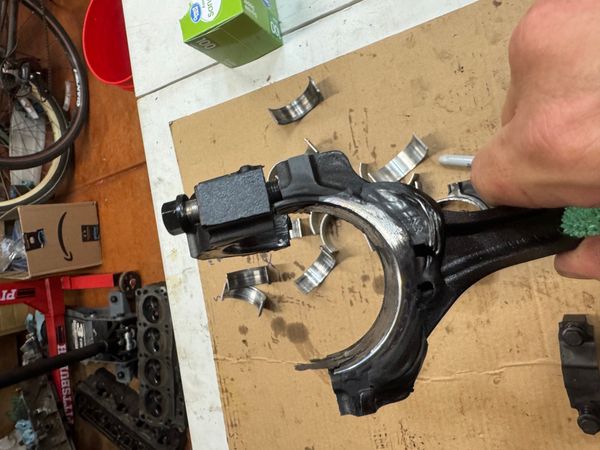

    As you see in the pictures, the first four pistons were heated to black and were seized to the crank shaft. The oil sump filter is clogged with a fibrous material - which I am thinking is it filter media. If so, that might have been the issue & caused the oil starvation. Then it started eating away at the bearings and sending metal material to the oil pan.

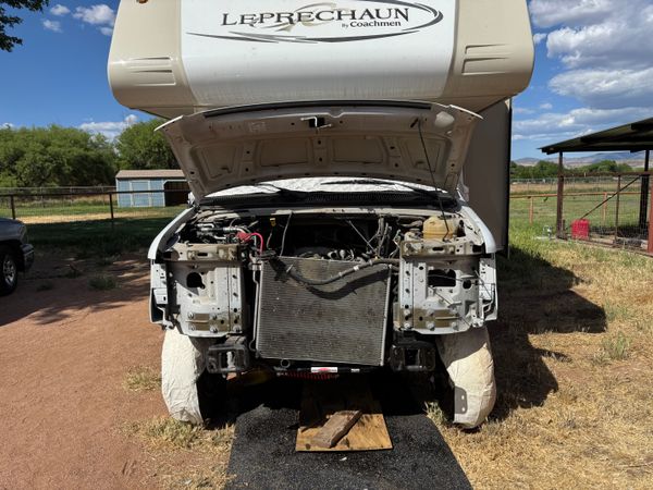

  • Here's part 1 of my update -

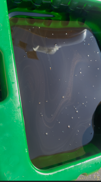

    I got to work on it this weekend. I drained the oil and there was close to 6 quarts and there was a slight metallic haze to it. No big chunks or anything catastrophic looking, but definitely a small amount of shiny particles floating on the surface. The oil filter was practically dry - I spun it off and turn it over, just a few drops. I got the whole front end off but had to call it a day. The RV is 90 minutes away from me at a family property, so I think next time, I will be able to pull the engine out and get it on a stand.
