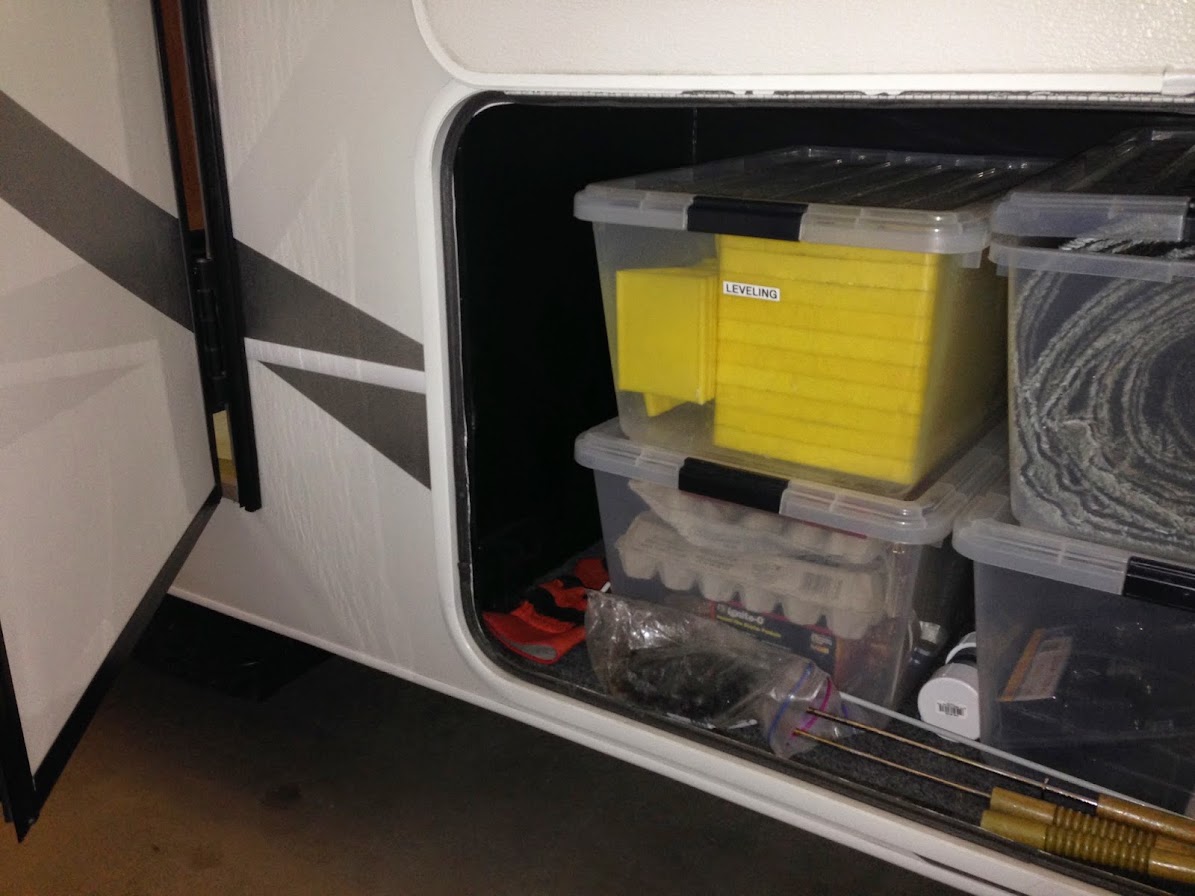

Tristar 60 Amp PWM Controller - This is my main question... I know this should be as close to the batteries as possible, so I have two options. Option 1 would be to mount it on the inside of the end of the couch where the inverter is. This would be rather tight to access for wiring (since I cannot move the big metal box that is the exterior storage). However, this would be an interior location if that is relevant. Option 2 (what I was hoping to do) would be to mount it in the external storage compartment that is under the couch (see photo below).
This is the exterior storage bay (the end of which is about 23" H x 23" W and there is currently about 6" between the wall of the bay and the first storage boxes). I envision mounting the charge controller and related stuff on this end wall which is just under the couch and therefore adjacent to the battery box.
