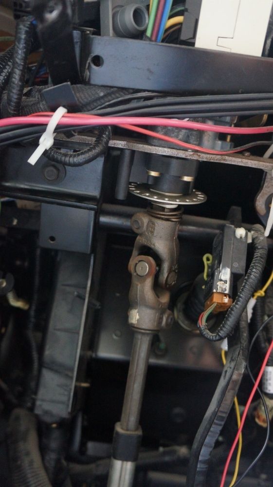

I wonder if anybody here can give me some advice. I have a 2001 Coachmen Mirada. Ford F53 chassis. The old voyager monitor bit the dust after a lingering illness. The front panel switches all fell back inside one at a time until finally it quit working entirely. It may have shorted inside. I have replaced it with a Rear View Safety RVS-770613. It is not the best but it is more than adequate and I couldn't beat the price. Install was straightforward. The old wiring was 4 wire and the new 5 but I didn't need the picture flip feature so I omitted that wire and installed the correct plug and socket on the old wire and all is well. Very simple job for anyone who needs do it.

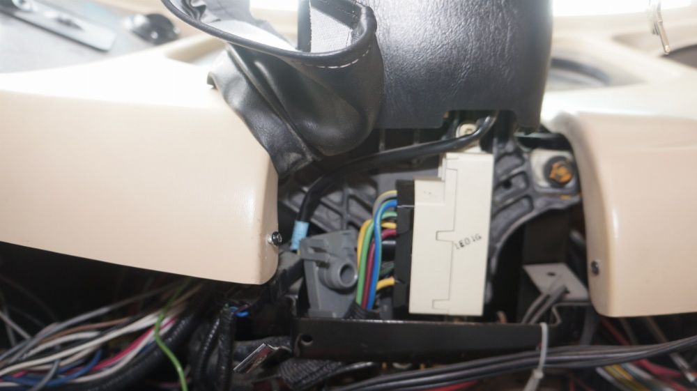

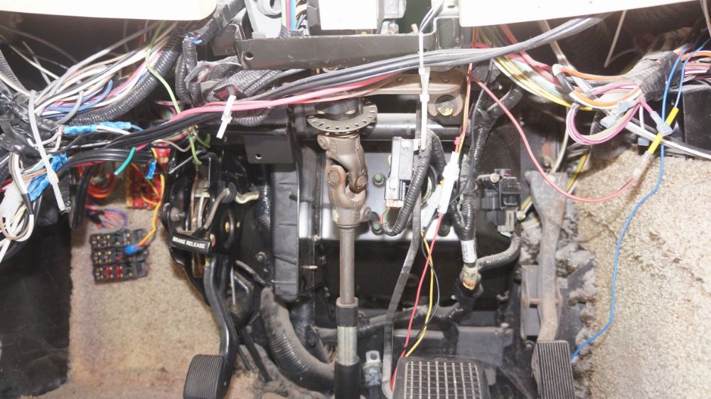

Here is the problem. The blue reverse trigger wire does not power on when the RV is shifted into reverse. It did work with the old monitor but it may have been shorted at some point when it quit. I have removed and tested every fuse in the coach (or at least the 3 panels I know of.) I followed the blue wire up to where it passes through the firewall. This is high and to the drivers side of center. I cannot be certain where it goes from there bit it may be spliced to a yellow wire that goes rearward along the frame behind the trans. The reverse lights work.
Is there a relay I am missing? Where does this trigger wire originate? Is there a spot in the shift lever wiring where I can hook it in? Do I need to connect it to a backup light and run a wire forward? I'd like to keep the original config but I can't figure it out. Does anyone know?
