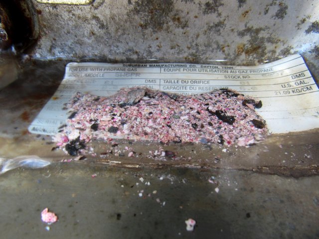

This the anode rode I removed when I first bought my camper last July. :E

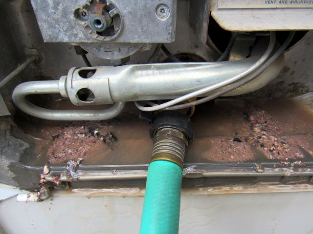

I flushed and flushed and flushed before all this junk quit coming out of it.
Its leaking into the foam insulation so I'm sure the tank finally rotted thru.

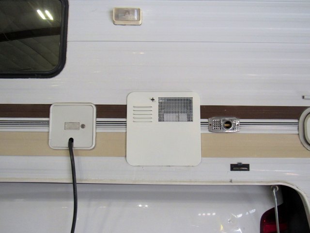

The think that surprised me when I first bought the camper is that it has most every option yet you have to go outside to light the water heater.
I'm going to correct that. ;)
