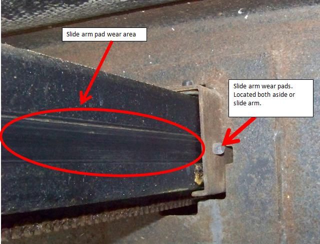

In stead of left and right, I'm going to use "Master rack or driving rack" slide arm, This has the hydraulic cylinder on it.

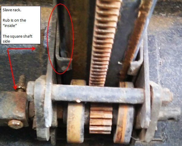

And I'm going to use "Slave rack or driven rack" slide arm as this one is driven by the square shaft.
Here is the Master rack. It shows the rub is on the hydraulic cylinder side. We can see the square shaft in this pic on the right. Facing the slide, the rub is on the left or the outside of the master rack slide arm.
Here is the Driven rack. It shows the rub is on square shaft side on the left. Facing the slide, the rub is on the left or the inside of the driven rack slide arm.
Since you reported the opposite wear pad was still good on both locations, while facing the slide from the outside looking at the camper, the slide room is forced to the left. Or forced to the hydraulic cylinder side. Both slide arms are showing the same effect.

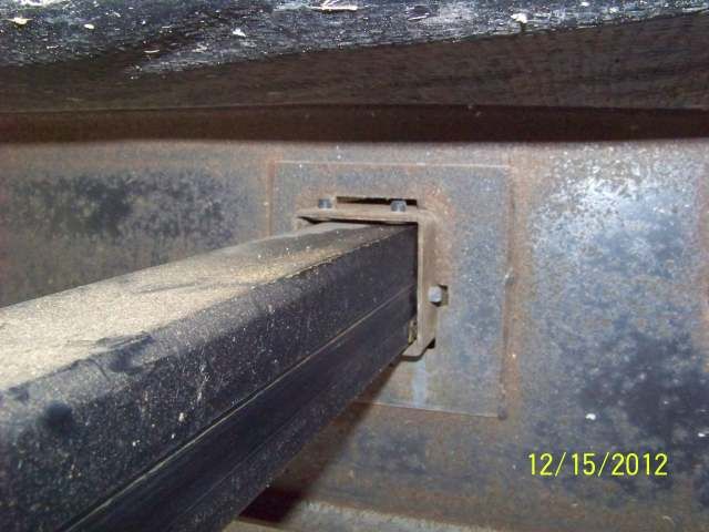

At the slide itself, the slide arms bolt to the bottom of the slide. Lippert has a few different ways they connect to the slide room, but all of them I have seen have long slots on the brackets that bolts to the bottom of the slide. See here on mine. These are pics during my slide floor rot repairs.
On mine, there is a bracket that bolts to the camper floor. If you look straight up at the floor, there are long slots that the entire slide can be pushed to the front or rear of the camper if I loosen those bolts. You cannot see those slots in my pics, but they are there.
Go and look at yours. I'm sure there is some type of slotted bracket that bolts to the slide floor.
