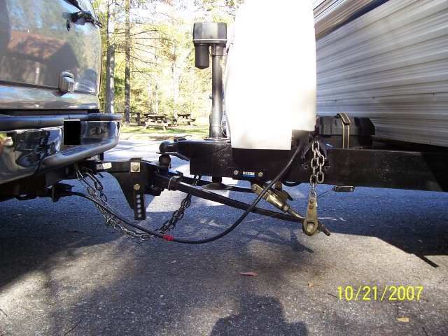

I'm working on setting up a new Reese Dual Cam setup. I think I need a 1" extended ball, and wonder if I would benefit from a 2".
Here's are some photos of where I'm at now:
Side view, I think snap-up can go back a little without having to move the gas mount.
It looks like the cam clears with 6 links, 5 wasn't as good:
Trunion and head bind (less that 45 degrees) (Any reason to NOT center the roll pin? It seems line both are sticking out on one side and are in 1/4" or so on the other.):
Bind on the other side (closer to 90 degrees).
