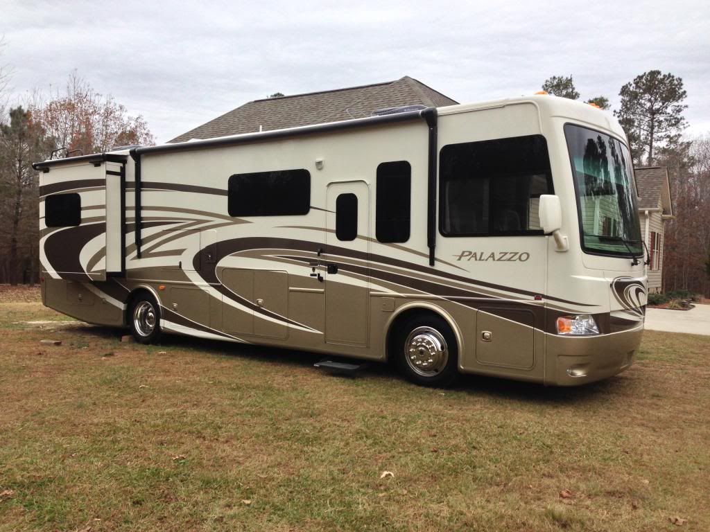

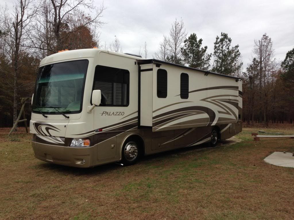

Please read the entire thread... The issue is with the Lippert Schwintek system. Well, that is one of the biggest problems. The motors are too small. The components are too weak and they are prone to failure. There is a small 12v dc motor on both ends in the wall. The motor is smaller than the palm of an average adult hand. To prevent front to back mis-alignment, they use motor synchronization controllers.
Schwintek
After you watch the video... Then go back to the beginning of this thread and see my photos and tell me if this operated the way it was supposed to, less than 3 weeks old. Approximately 15 slide outs... - 93mastercraftExplorer II
